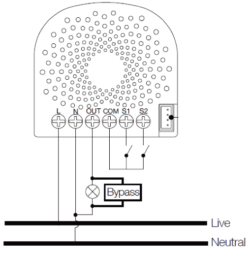

Assuming your wires are not to old...
Why not...
Connect Brown to L. Blue to N (this way the dimmer has power)
Connect OUT to the black wire(s) going to the lamps (assuming you have two seperate (ceiling) lights)
connect the two wires from your existing switch (only) to COM and S1 (or S2)
The bypass is only used for small power loads as i read it in the manual, probably not nessecary.
This way you can switch it manually and by remote the way i see it.
Why not...

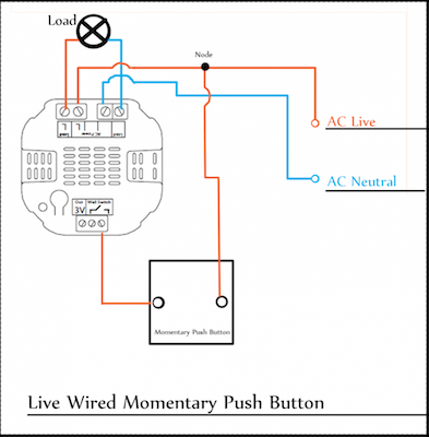

Got it on the power connections to power the dimmer. The wires from my existing switch form the circuit, so I can't re-use (If I leave switch in place, it'll turn the nano dimmer on/off i.e. supply or cut power to the circuit). Bypass is needed as I'm using low power LED (12W total on 230V). Think I'll give it a go...
Found this (which would allow me to continue to use my switch in place, but only works with Micro Switch and NOT dimmers - specifically warns of this approach for dimmers)
- MicroSwitch.png (110.52 KiB) Viewed 1253 times
