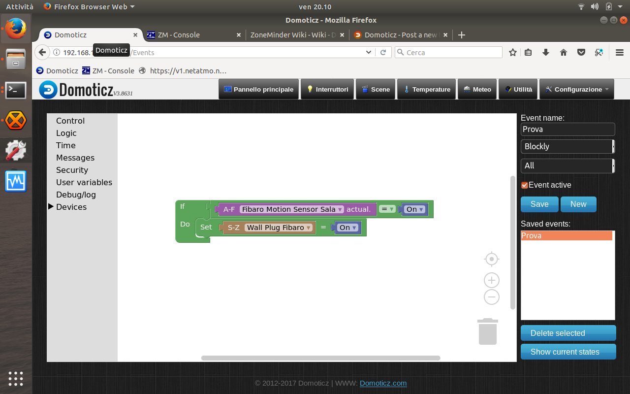

Hi guys, i'm trying my firts blockly
bun nothing happens
why?
tnx a lot

nothing change...
log write : 2017-10-29 18:22:40.670 EventSystem: reset all events...

What does the 'current status' say about the sensor?.. thats the value you need to switch. And what about the light turning off.. you can't switch a light on that is already turned on.

Hi Hans,DutchHans wrote: Sunday 29 October 2017 18:58 What does the 'current status' say about the sensor?.. thats the value you need to switch. And what about the light turning off.. you can't switch a light on that is already turned on.
Cheers, Hans
current status is on/off both, the light start off and i want to switch on

The motion sensor switch is wrong. Your using a utility switch (purple), you need to use the switch under Devices --> Switches.

Thank you so much, now i understand the problem and all is ok!!!!!!!cogliostrio wrote: Sunday 29 October 2017 19:40 The motion sensor switch is wrong. Your using a utility switch (purple), you need to use the switch under Devices --> Switches.

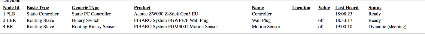

Hi, i meant cuttent status in the blockly environment. (The button on the bottom-right) You can see there what the value is when its idle and when the sensor is active.. depending on the type it could be on, motion or alarm etc...

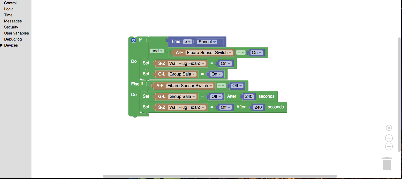

Hi guys,
i'm implementig the blocky with other functions.....
i want that light switch on when motion sensor is on AND after SUNSET...
Now event don't do, without sunset function all is ok.
Any suggestion?
Thanks so much

Hi,dextm80 wrote: Monday 30 October 2017 11:59 Hi guys,
Any suggestion?
Thanks so much
I think you need "After Sunset" followed by "AND < 22:00" or perhaps for all night:- "OR Before Sunrise" so there is a distinct period for the condition.
