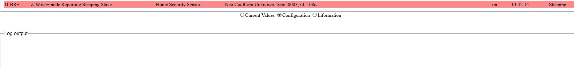

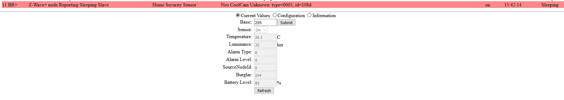

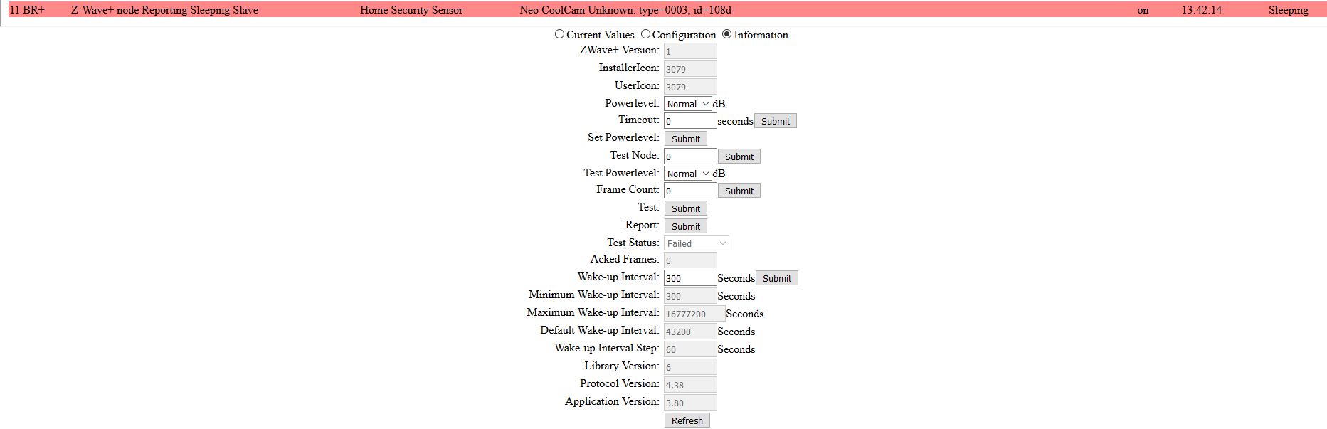

edwindred
Posts: 18
Joined: Friday 27 May 2016 17:52
Re: Neo CoolCamlight switch: Unknown: type=0003, id=108b+
Post by edwindred »
Solution found.
the openzwave xmls are not completely up to date.
i found that adding one line in the manufacturer_specific.xml did the trick.
<Product type="0003" id="108d" name="Battery Powered PIR Sensor" config="shenzen_neo/nas-pd01z.xml"/>
And then excluded and include again. Now I am able to set parameters
