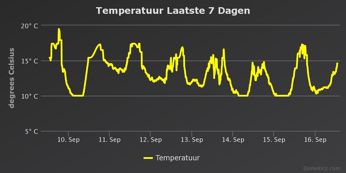

Hello, I am a newbie on this forum. But we have a well-automised Domoticz system running our electronics.
Everything works perfectly, but I see at our thermometer outside our house that it only gets data of >10 celsius.
I gets updates as normally so the sensor works.
Our weatherstation gets normal data, also below 10 degrees, but domoticz doesn't.

I see no updates anymore from the sender via 433Mhz below 10 degrees in the log, the last one is:
69 RFXCOM 433 0A01 1 Tuin temperatuur Temp THR128/138, THC138 10.0 C 5 Laag Log 2017-09-17 04:29:57
But the Huger weatherstation is receiving data because it had a value of 7.4 at that time (7:49). So the 433 receiver doesn't get a signal or is ingoring it. 433-Receiver is indoors and getting data from all the other devices with no problem.

Looks like something is wrong in Domoticz, see log of Domoticz:
2017-09-17 03:45:00 10
2017-09-17 03:50:00 10
2017-09-17 03:55:00 10
2017-09-17 04:00:00 10
2017-09-17 04:05:00 10
2017-09-17 04:10:00 10
2017-09-17 04:15:00 10
2017-09-17 04:20:00 10
2017-09-17 04:25:00 10
2017-09-17 04:30:00 10
2017-09-17 04:35:00 10
2017-09-17 04:40:00 10
2017-09-17 04:45:00 10
2017-09-17 04:50:00 10
2017-09-17 04:55:00 10
2017-09-17 05:00:00 10
2017-09-17 05:05:00 10
2017-09-17 05:10:00 10
2017-09-17 05:15:00 10
2017-09-17 05:20:00 10
2017-09-17 05:25:00 10
2017-09-17 08:55:00 10.1
2017-09-17 09:00:00 10.3
2017-09-17 09:05:00 10.5
2017-09-17 09:10:00 10.8
etc.
