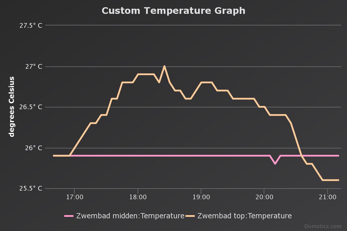

I installed three temperature sensors in my swimmingpool on different heights, connected to Domoticz using a Fibaro binary sensor through Z-wave. The idea is to gather enough data to optimize the pump with and to check the effect of our solar deck.
Unfortunately, one of the sensors for whatever reason returned a false reading of 0.0 degrees. This disturbs the graph Domoticz can draw:
The "zwembad onder" has a false reading at 17:20 hours today. If I remove the whole sensor from the graph, autoscaling works again, showing some useful information on bottom and middle sensors.
chart (1).jpeg (52.57 KiB) Viewed 2708 times
So, the bottom line question: is there a way to remove (or better: to edit) that false reading from the Domoticz database? If so, how? I run Domoticz on a RPi3, latest stable version if that is of any importance.

Yes, you can remove them. Hold your [shift] key on your keyboard and click on the bad data point. This should pop up a window asking you if you would like to remove it.
I think there needs to be more ways to edit this information though. Perhaps a table view.
Hope that helps! 8-)

Ah, works like a charm, thanks!
Yeah, it sure would be nice if we could edit in the table view.
