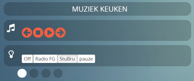

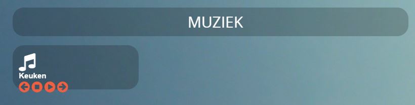

That was easy ! So now I become this.
How to fine tune it more to become bigger buttons (play, pause,stop,...) ? And to choose from some playlist , favourites ? Maybe albumart ? ;)

capman wrote: Saturday 12 August 2017 13:47
That would be nice indeed.
The button size I found out myself and added it to the wiki:
http://www.domoticz.com/wiki/Dashticz_V ... er_buttons

I also found a site with some info about this subject. http://tutoriels.domotique-store.fr/con ... -http.html
But the main question is how to integrate this in the dashticz frontpage. I can copy some html code , but where should I past this ? Once I know how this works , I'm set to start. ;)
freakshock
Posts: 64
Joined: Friday 14 April 2017 13:39
Re: Dashticz - Install picoreplayer
Post by freakshock »
I'm too much of a noob to do this, but it would be great if we could get something like the Spotify plugin, with album cover, playlist selection and perhaps also volume control. Shouldn't be too hard to make a slider like element that calls the volume url's.
What I did manage to do is find links for my Spotty plugin playlists with inspect element in chrome.
Example:
http://192.168.1.73:9002/plugins/spotty/index.html?action=playall&index=7.2&player=cc%3Acc%3Af4%3A24%3Ae7%3A21&sess=&start=&_dc=1501273859963
I made a selector switch in Domoticz and pasted a few URL's of my favorite playlists in there. That way I can choose a few playlists from within Dashticz:
capman
Posts: 166
Location: Belgium
Post by capman »
Okayyy , getting something here 8-) Have made a selector switch with two url's to my playlist with each a radio station.
http://192.168.178.29:9002/status.html?p0=playlist&p1=play&p2=RadioFG&p3=b8:27:eb:29:3c:50
and
http://192.168.178.29:9002/status.html?p0=playlist&p1=play&p2=StuBru&p3=b8:27:eb:29:3c:50
Just like freakshock say. Thanks freakshock!
Now I just have 2 make a selector switch in dashticz and we have control about my player (stop , play). And a selector with some favorites in.
Next thing to do , volume control :D .
Thanks 2 everybody 4 all help so far !
