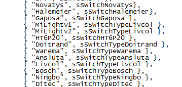

the problem is on the file : "RFLinkBase.cpp"
if i change the type of hardware on this file and i compile domoticz with this edited files , when i add the light living colors gen 1 on domoticz now i can switch on and off the light !!! i can set the intensity but not yet the colors of leds ...
here is the change i do on this file :
before ( original file )
Capture d’écran 2017-08-22 à 21.18.52.png (19.38 KiB) Viewed 5387 times
after ( modified file )
Capture d’écran 2017-08-22 à 21.17.47.png (19.96 KiB) Viewed 5387 times
any one can help me to solve my problem and being domoticz full compatible with living colors gen 1 and RFLINK ?
thanks in advance for your help

belgo wrote: Tuesday 22 August 2017 21:30 hello evey body ,
i continue to investigate and i'll try some things ...
belgo
Hi Belgo,
Is it just me or what? I’ve been comparing both screenshots but can’t see any difference. Could you please let me know what you changed exactly to get this to work?
I’m currently in the process of getting the level shifter and the CC2500 soldered together. This will probably take me some time and lots of frustration since the pins are so god damn small 😂. Would be a pity if after all that misery the solution would not work although stated as supported.
