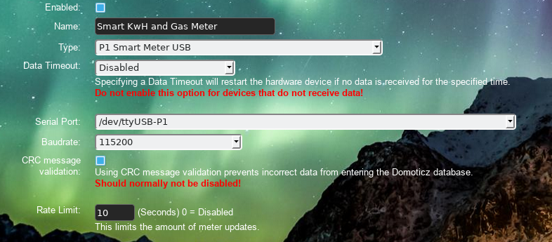

Okay, there is a solution for limiting these logs. This solution have been there all the time, but i never saw it before.
On the hardware tab, select de P1-LAN meter, and change the 'Rate Limit' to a higer value. In my case I did use 120 seconds.
For me this is more than enough, and it will keep your logs readable.

As the previous poster already mentioned, there is a solution to limit the log
See:
By increasing the Rate Limit you will also limit the number of log entries.
