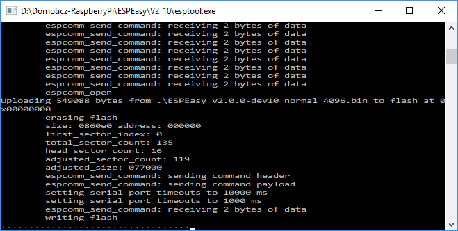

As 'operating system' I choose 'ESPEasy Version 2.10':
https://www.letscontrolit.com/wiki/index.php/Main_Page
Install the setup-program on your computer.
Then you start the tool FlashESP8266.exe and choose the version. I used 'ESPEasy_v2.0.0-dev10_normal_4096'. Of course, when you read this, there can be a more recent version available. When the flashing is done, disconnect the Wemos D1 from your Computer and connect it to a seperate power adapter. I found that this makes it easier to perform the following steps.
ESPEasy will now start as a Wifi Access Point with network-name ESP_0.
Use (for example) your telephone to scan for the network 'ESP_0'. Connect to this access point with password: configesp. Then launch your internet browser (and perhaps press the home button) and it should find the active portal hosted by the ESP module.
From the screen 'Welcome to ESP Easy' choose your network and then type the access-password of that network. After clicking the connect button, ESP easy will connect itself to your network and get an IP address. Make a note of that IP-address.
Press the reset button on the Wemos D1.
If you don't see a screen with a new IP-address, try again, or search for the new device/IP-address in the connected devices list of your router.
Now, on your PC, start a browser and connect to the IP-address of the Wemos D1.

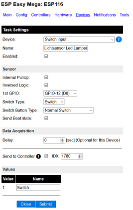

Menu --> Devices
Click the Edit-button for Task number 1.
A sub-menu 'Task Settings' appears.
- Device: Select 'Switch input'.
- Name: This likely will be the name of the device you want to monitor.
- Enabled: Click the box.
- Internal Pull Up: Click the Box.
- Inverted Logic: leave empty.
- 1st GPIO: Select the dummy device you prepared in the hardware-menu: GPIO-12 (D6).
- Switch Type: Switch
- Switch Button Type: Normal Switch.
- Send Boot State: Click the box.
- Delay: Leave zero
Send to Controller: Here you enter the Domoticz-index-number of the Device you want to monitor. And you click the checkbox to enable it.
Click Submit.

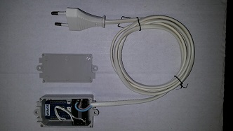

Build the hardware
For the detection device I used:
- 'Wemos D1 Mini V2-ESP8266-12F - CH340
- 'Hi-Link PCB power-supply - 5VDC, 0.6A - HLK-PM01'
- Housing
- Line cord
You solder the line cord to the power-supply and the plus and minus to the Wemos D1. Put it in the housing and use some double sided tape to keep it all in place.

If you want a quick(er) response that the device is On or Off, you should leave the Wemos D1 powered on all the time and use a sensor to see if the Device were are monitoring is On or Off.
As sensor a light-sensitive resistor will do. You can build your own Opto-coupler by using a light that is put On or Off together with the Device to monitor. I used a so called neon light.
The light-sensitive resistors are fragile. Use some shrink-tube to strengthen it.
This is how you make your 220 volt opto-coupler: Connect one of the wires of the light-sensitive resister to your Wemos D1. Best is one of the pins D5, D6, D7 or D8. Connect the other wire to ground.
This is the task-setting for the switch: When the light-sensitive resistor gets no light, the resistence is high and there is no current flowing (to ground). The Internal PullUp resistor in the Wemos D1 makes that the GPIO pin is High. So the device seems to be On. But... because of the 'Inversed Logic' it is set Off.
When the light-sensitive resistor does get light, the resistance is low and it is connecting the GPIO-pin to ground. So the pin will be Low and the device seems to be Off. But again, because of the 'Inversed Logic' it is set to On.
This state will be immediately send to your Domoticz computer and the device with the corresponding Idx will be set accordingly.
When the device you are monitoring has a light-source of itself like a power-light, or perhaps because it is a light iself, you can place the light-sensitive-resistor on top of that light-source. Just be sure that it is realy dark when the device is off.

I had a prototype where a capacitor (2 x 4700 micro Fahrad) would keep the Wemos D1 'alive' for three extra seconds after the power-supply went down.with quite a big storage capacitor
I used an Optocoupler on that power-supply with the switching-side on the Wemos D1. This was supposed to trigger the 'Off' State which should be transmitted in those remaining three seconds. I could measure the sequence of events as expected, however, the Off state was never send.
I assume the power of the capacitor(s) still was to little.
You would need the red capacitors as on the picture (Polypropyleen 220 n; 600 volt AC !), diodes, resistors and normal Capacitors to flatten the voltage. The price for the needed parts together would be the same, if not higher, as the price for the Hi-Link PCB power-supply (5 Euro).create a 'capacitive dropper' power supply
So you could even use two Hi-Link power-supplies: One for powering the Wemos D1 and one to be switched On and Off with the Device To Monitor and so acting as an On/Off sensor.
