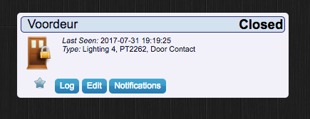

Been struggling getting the following to work without success.
I have Chuango DWC 102 magnetic door/window sensor.
I have a RFXTRX433e.

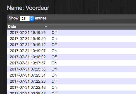

Domoticz is correctly configured as in it receives the "Open/On" states from the door sensor.
I have an off delay configured on the door sensor of 5 sec, because it only sends 1 state and that is "Open/On"

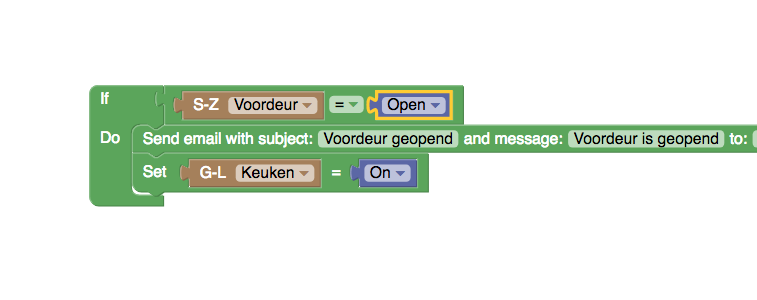

I want to create a blockly event that sends me an e-mail or turns on the light when the door sensor is triggered Open or On, but the lights or e-mail is not triggered.
I have tried various states such as Open, Close, On, Off, Alarm... non works.
When I create a different event such as, when light turns on, send e-mail to X, this does work.

Finally found what I did wrong....
The only difference between my test events which did work was that I had set my test events on "All" in the drop down box whereas the event with my door sensor I had set " Security"
