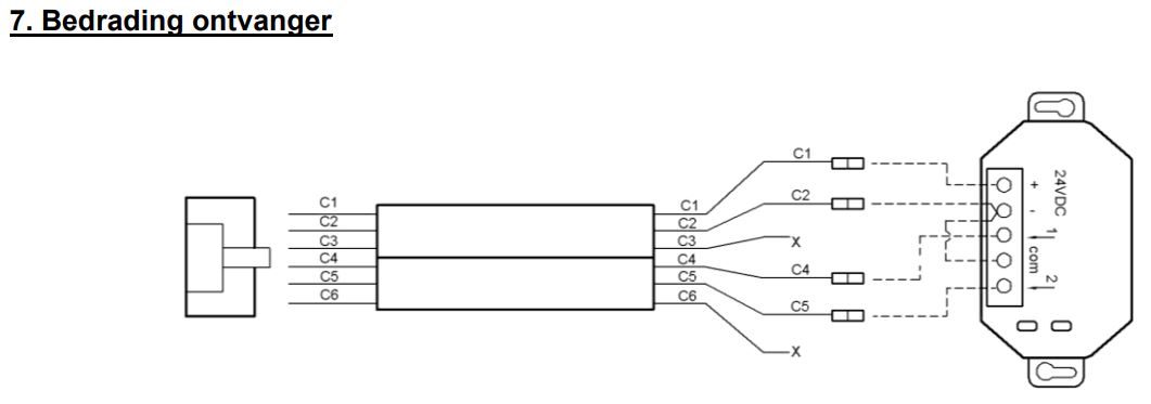

Next thing would be to power the whole device from the internal 24v of the WTW. Seems possible as described here.
https://www.brinkclimatesystems.nl/geta ... c19b8ddb90
Using the following cable lay-put. Currently mine is 3 wires only so have to modify it to 6 wire.

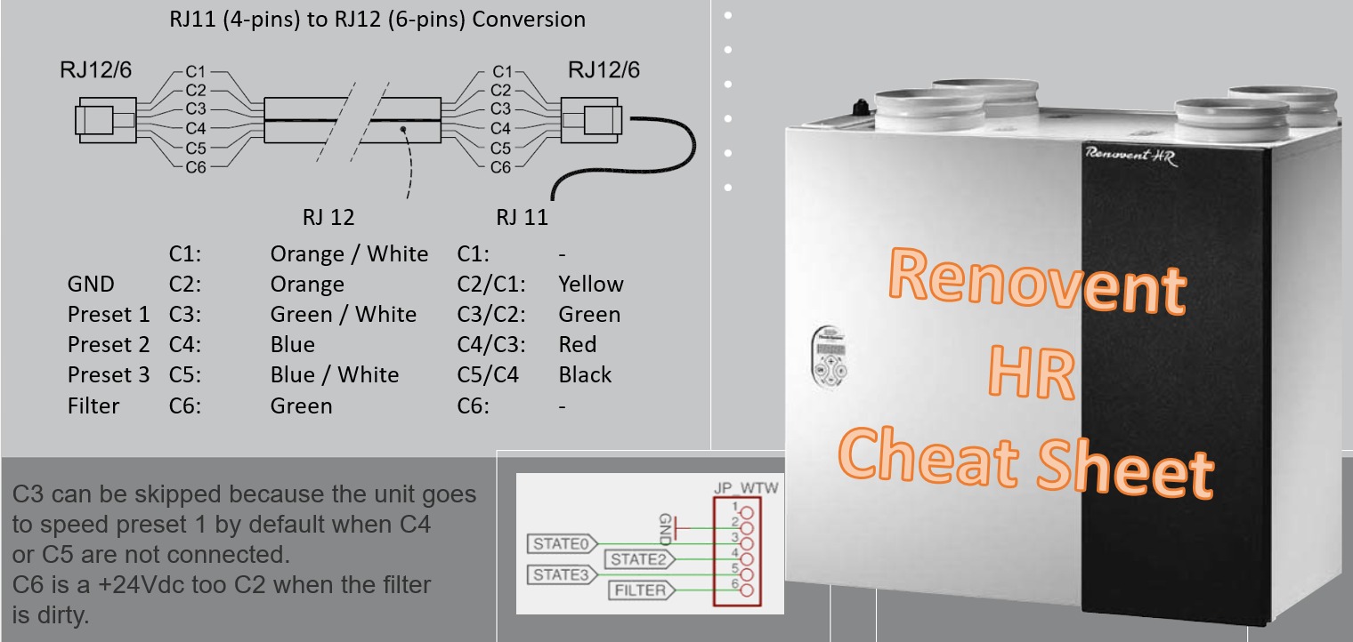

Just for some extra information:
C3 is speed preset 1
C4 is speed preset 2
C5 is speed preset 3
C6 is dirty filter alarm indication.
C3 can be skipped becaurse the unit goes to speed preset 1 by default when C4 or C5 are not connected.
C6 is a +24Vdc too C2 when the filter is dirty. I used a solid state relay to create an isolated signal to connect this output to my PLC.

I summarized the information of this topic in a cheat sheet.
Source: https://github.com/IngmarVerheij/RenoventHR/
It can be used to convert the standard RJ11 to a RJ12 solution including filter warning (was not included by the building company in my setup)
Renovent Cheat Sheet.jpeg (160.68 KiB) Viewed 8642 times
Only thing I need to do next is find out (without using buck converter) how to convert the 24v to an acceptable digital in for a raspberry / arduino digital '1'.

In addition to this, can above be realized with a shelly 2.5 as shown in picture, so with C1 to N, C2 to L, C4 to SW1 and C5 to SW2? It would help me a lot because I am a relative noob as it comes to this kind of automation. :)
Any confirmation or correction will be highly appreciated! :lol:
Thanks in advance...
rgroothuis
Posts: 347
Re: Renovent HR Medium/Large - Brink Climate Systems
Post by rgroothuis »
Well, I'm not sure if that is possible. Not sure if there is 220V on one of the pins you are using the switch the climate control system. If there is 220V on the output for sure you will damage your climate control system.
That is why I'm using the Fibaro Smart Implant which can switch low voltage outputs. I'm using this now to control, amongst other devices, the climate control system.

It's my intention to connect it to the RJ12 connector of the WTW with a standard flat cable and connector which also will provide the shelly of current. So no 220V involved. My simple thoughts were that this was the most simple solution (maybe not the cheapest, but I already had one laying around).
Like I said, I am not a specialist in electronics. So other options are interesting but then I need a step by step guide... and my googling skills brought me to this topic among others and for me the most clear. :)
rgroothuis
Posts: 347
THat will not work. Your shelly device needs 220V to power up! At least that is my expectation. WIthout 220V you cannot control your Shelly device.
