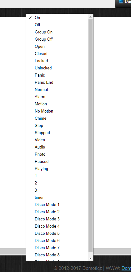

the only issue i have is is it possible to alter and add custom switch states?
below are the current options.....can you add more?
or perhaps is there a way to make the blocky logic use the value levels of 10, 20, 30 for the switch state?
switch state list.PNG (32.42 KiB) Viewed 2256 times
Re: 3 way switch
Posted: Tuesday 18 July 2017 6:56
by Jan Jansen
Yes, you can use Blockly (see tab logic > Level%)

unfortunatly it seems level " " % can only be used in a do statement, it cant be used as a factor in the if part...or at least i cant get it to work........
how ever ive now changed it to off/timer/on and that works within the parameters allowed
is there any way to go about changing the available switch states?
Re: 3 way switch
Posted: Wednesday 19 July 2017 8:34
by Jan Jansen
Click tab User variables. Then click " ". Then fill the field with for example Level1.
succes
Re: 3 way switch
Posted: Wednesday 19 July 2017 17:07
by tozzke
In the if-statement you're supposed to use the name you've given each level and in the Do-block you should use the level % indeed

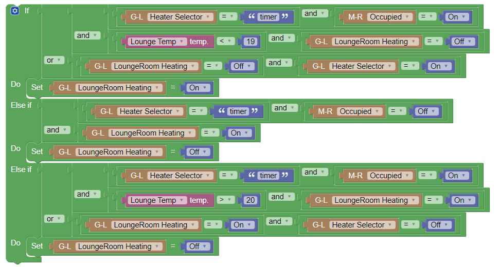

Posted: Friday 21 July 2017 1:40
by markjgabb
hey tozzke
thanks for you tip
i have done as you suggested and pasted blocky below.....
everything seems to work except temp too high or temp to low parts of blocky....im not sure that its perhaps not a seperate issues, but events currently seem to not be being triggered by temp values
Re: 3 way switch
Posted: Friday 21 July 2017 6:30
by tozzke
markjgabb wrote:hey tozzke
thanks for you tip
In your first if-statement you've got 'or [LoungeRoom Heating] = [Off] and [Heating Selector] = [On]' but a selector switch doesn't have the state 'On'. Or have you called one of the states of the selector switch 'On'? In that case you have to use 'or [LoungeRoom Heating] = [Off] and [Heating Selector] = ["On"]'. This doesn't fix the problem with the temp you're having though.
How did you call the level "timer"? isn't it by any chance "Timer"? Because this might be the problem that it won't trigger @ temp :)
