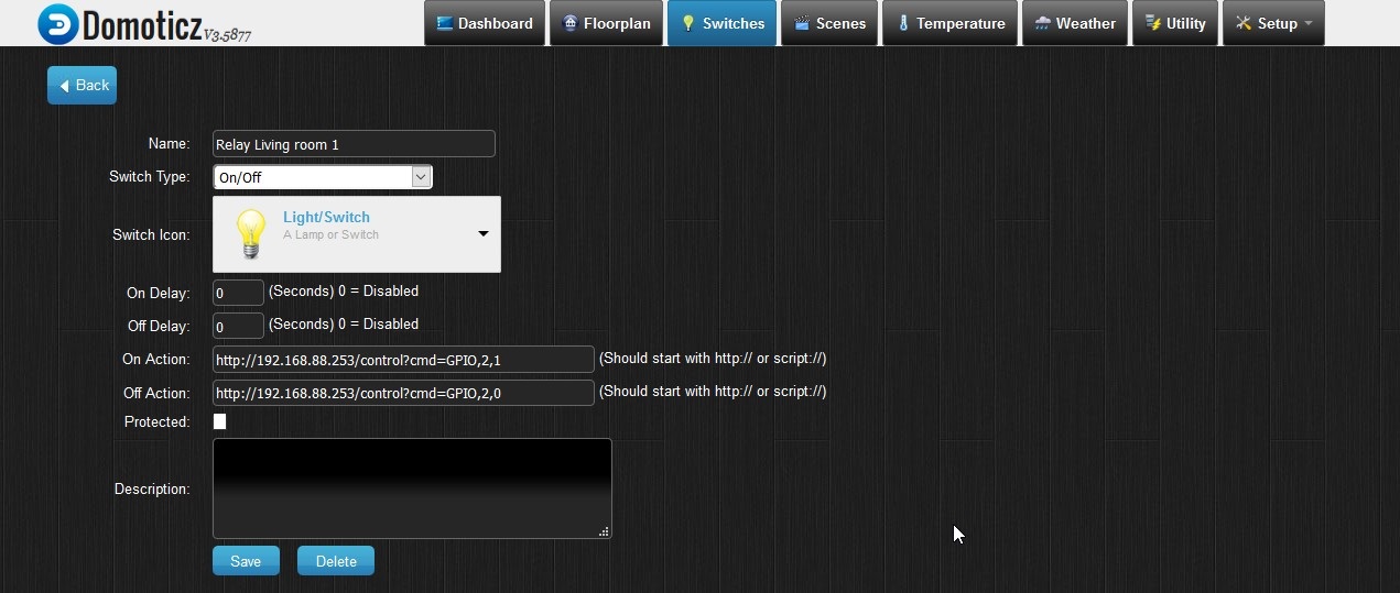

Switch configuration
ScreenHunter_302 Jul. 04 18.58.jpg (151.39 KiB) Viewed 2054 times

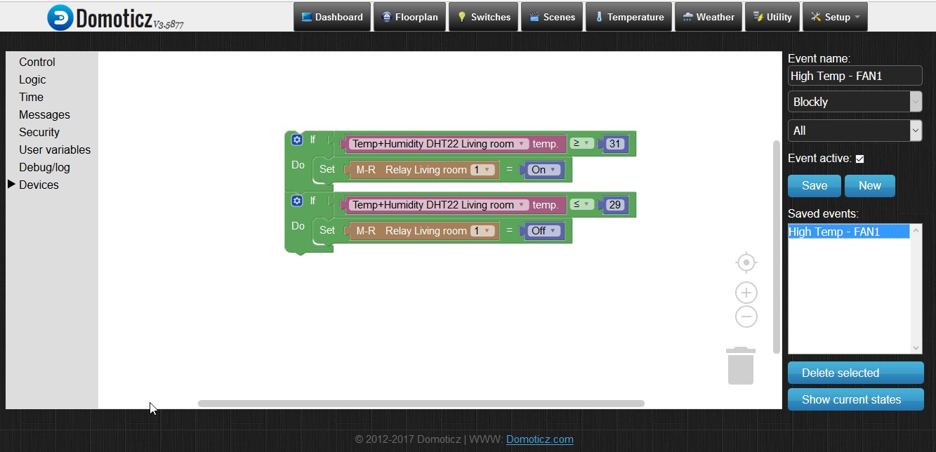

Blockly
logic
logic
ScreenHunter_305 Jul. 04 19.57.jpg (114.65 KiB) Viewed 2054 times
I think this should work but it doesn't. What I am doing wrong?

Ad the state of the switch in the first line, so if temp=31 and switch is off set switch on.

I think this cannot work because:-
1. You have used an "If / Else If" block without an Else If. This will not work, use the other "If " block without the blue gear symbol.
2. You have joined 2 of these together. This will not work either.
Try to redo this with a single If / Else If block something like:-
If living room temp > 30 and Relay = Off
Do set Relay = On
Else If living room temp < 30 and Relay = On
Do set Relay = Off
Hope that helps.

It works like I expected ;-)
Once again, many thanks for both of answers
