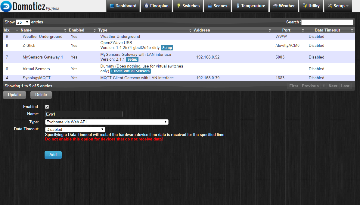

Hi guys just moved to Domoticz on my Synology NAS from Vera and getting set up, I see you can add your Evohome hardware using the web api, I had this working on Vera. However when I go to Hardware to add the "Evohome via Web API" hardware nearly all of the options shown in the wiki are not there, all I can add is the name. I can click add but nothing happens. A picture paints a thousand words
Do I need to install anything extra?

Have you tried refreshing your cache in the browser as it might still be using the pages from the previous version and hence the options aren't appearing.
Dan
