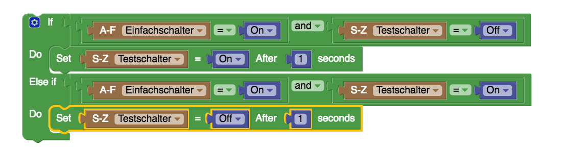

Hi there I am a total n00b and just starting, now i have a blocky script i would like to translate into Lua (because I need it more often and Lua is easy to copy) Tried a lot but failed, maybe somebody can push me into the right direction :?

   if otherdevices['Einfachschalter'] == 'On' and otherdevices['Testschalter'] == 'Off' then
      commandArray['Testschalter'] = 'On AFTER 1'
   elseif otherdevices['Einfachschalter'] == 'On' and otherdevices['Testschalter'] == 'On' then
      commandArray['Testschalter'] = 'Off AFTER 1'
return commandArray

my understanding of the Blockly script is to toggle Testschalter after 1 sec when Einfaschalter is on....
yes... Testschalter will flash 1sec while Einfachschalter id ON....
Wasn't this the intention? :oops: :oops:

The difference with the Blockly code is that it will only act of a devicechange event and your script will trigger each time it is run by an event.
So to reflect the exact code you need to use devicechanged:
   if devicechanged['Einfachschalter'] == 'On' then
      if otherdevices['Testschalter'] == 'Off' then
return commandArray

Thanks to all, my problem is I am using a wireless Xiaomi Aqara Wall Switch, I have to set the off delay to 1 sec otherwise its not switching off again. Therefore I have to use a dummy switch to use the switch in my homekit (Apple). Maybe I went wrong with my script and thinking....
I would like to get rid of the 1 sec delay.

I think I start to understand all these:
         commandArray['Testschalter'] = 'On'
         commandArray['Testschalter'] = 'Off'
return commandArray
Its now working perfekt, thanks this a really a great community!!!!
