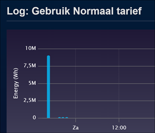

no, its a counter value that is extremely high and must be removed, but it is still there when i 'removed' it

This is a very old thread, but I'm running into the same problem. I confirm the deletion, but the value remains visible. What is the best solution to get this removed?

It is an Electric (Instant+counter). First value very high.
Both refresh page and holding shift did not do the tric.
I guess I have to go into the database and see how and where it is stored.

For me removing an incorrect value only works in the week, month or year graphs. Not in the day graph. But it could also depend on the type of device, not sure.

waltervl wrote: Wednesday 07 January 2026 23:05 For me removing an incorrect value only works in the week, month or year graphs. Not in the day graph. But it could also depend on the type of device, not sure.
Ah, maybe that is the solution. (But in that case it is strange that a popup appears to confirm the removal!!)
I managed to remove it from the monthly overview. I will see what happens to the daily value as time goes by. Thanks so far.
