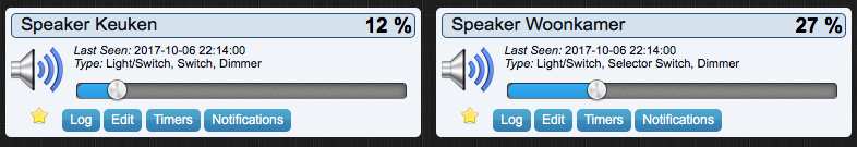

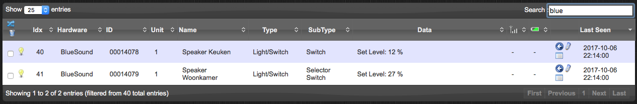

This is my setup for my Bluesound speakers. At this moment all I do is volume control through Domoticz
I've not used the mentioned API because i think the Bluesound speaker AP itself is already useable enough.
1 create a Virtual Dummy hardware device: Bluesound 2 Create your Virtual Switches (the speakers) 3 LUA script to translate the Domoticz controls into http requests for the speakers. (Set the script to "Device")
4 Syncing the volume of the speaker with Domoticz through a LUA script.
When the volume of the speaker is set outside of Domoticz this script will sync its interface with the actual volume of the speaker. (Set the script to "Time")

Got it. It is the way you create the dummy switches. They actually have to be switches instead of soundlevel, as I falsely thought.
Later to change in Switches to dimmer. Works like a charm.
