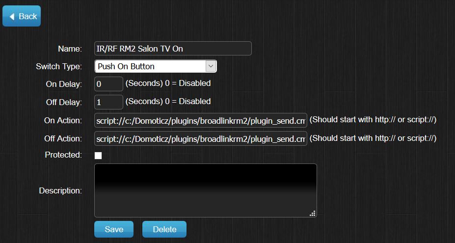

if you need for some reason to repeat the command, I think that all is already there:
in this case this will repeat the code 3 times.
And even more , on LUA script, you can use :
commandArray['IR/RF RM2 Salon TV On'] = 'On REPEAT 2 INTERVAL 1 SECOND'
