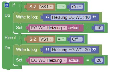

Here you are:
See Attachement The script as such is executed in this case (Messages are written into the Log)
However the Set-Commands are totally ignored, no message, no Failure message, no hint at all in the log, why this is ignored.

Isn't this because you simply can't set the '... actual' block? that it's just a read out of this specific sensor?
When I add a dummy thermostat ( I don't have a smart thermostat myself), I get to add this block (under Devices - SetPoints)
Shouldn't you use this block instead?

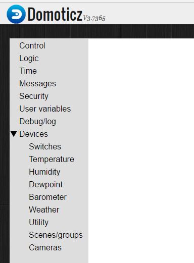

In my Devices Menu there are no Setpoints:

Hmm, could you take a look in Chrome Incognito mode. If that's possible?

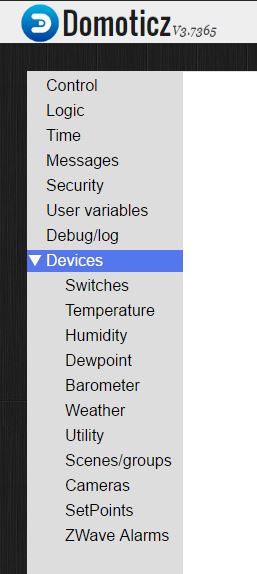

Re: Blocky Commands ignored
Yeah, in Chrome Incognito Mode it seems to work:
But how do I get it working in my normal Chrome environment ?
Chrome App-Cache Cleaning (as described in Domoticz User-Manual) does not help.
I tried this several times.
