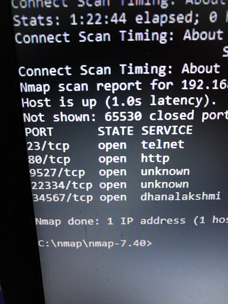

After setting up the wifi from the app I thought that it would be easy to log in using port 8080, 80 or similar and just find the correct path to the videostream.
I have done a portscan and port 80 and 23 is open and I also found that port 22334 is used from spying on the packets from my android phone.
I tried a lot of paths using iSpys camera url generator but none of them work. if I just enter <IP>:80 in a browser I get a file downloaded witch contains only this: "<H1>Index of /mnt/web/</H1>"
I also tried hydra on the telnet port 23 using some camera password-lists from github. But it takes forever to complete. I also tried all random telnet user/pass combinations I could think of like: admin:admin, admin:(blank), root:root, etc.
Anyone knows how I should proceed? And would access to telnet get me anywhere? My goal is to be able to get the videostream by URL so that I can add it in some camera software.

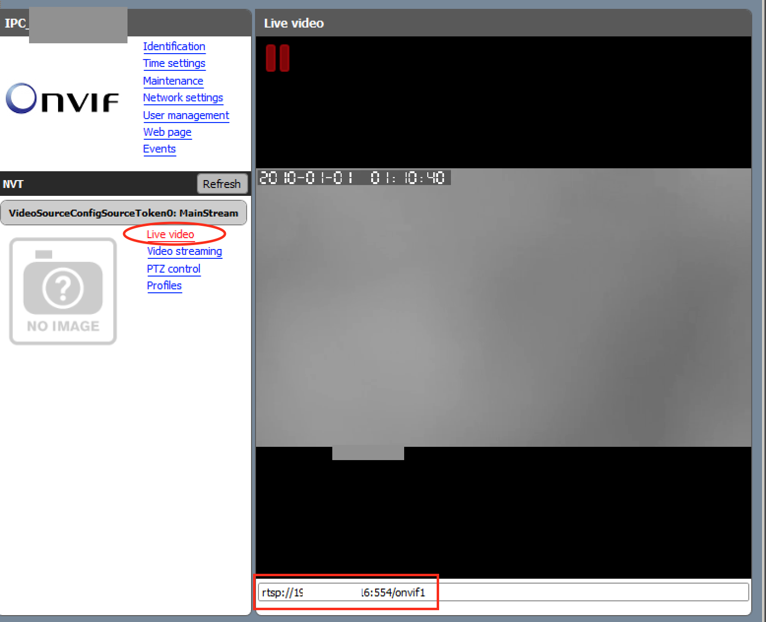

Try if Onvif device manager detects it:
https://sourceforge.net/projects/onvifdm/
If it does..you can retrieve streaming url.

Hi!kubrik wrote:Try if Onvif device manager detects it:
i also have the same problem with 2 cheap china ip cameras, i have installed the onvif device manager and it picks up the 2 cameras as a onvif device, but how can i see what url the camera uses for the stream?

Under the stream video you can see the streaming url:

I found the streaming url, put it in to Domoticz... but still no videostream in Domoticz. Digoo DG-M1Q Onvif Camera

i 've been playing with my IPC365 yesterday night.
and i found 5 ports open
23/tcp
80/tcp
9527/tcp
22334/tcp
34567/tcp

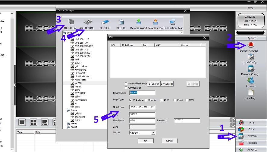

go ahead and download CMS from the link below
http://www.colincctv.com/Upload/%E8%B5% ... r%20PC.zip
add the device using the ip address given by your dhcp
use the port 34567
username : admin password: 123456
you will only connect to main stream
aswell you can login to configuration and change many other paramenters.
Hope this helps you

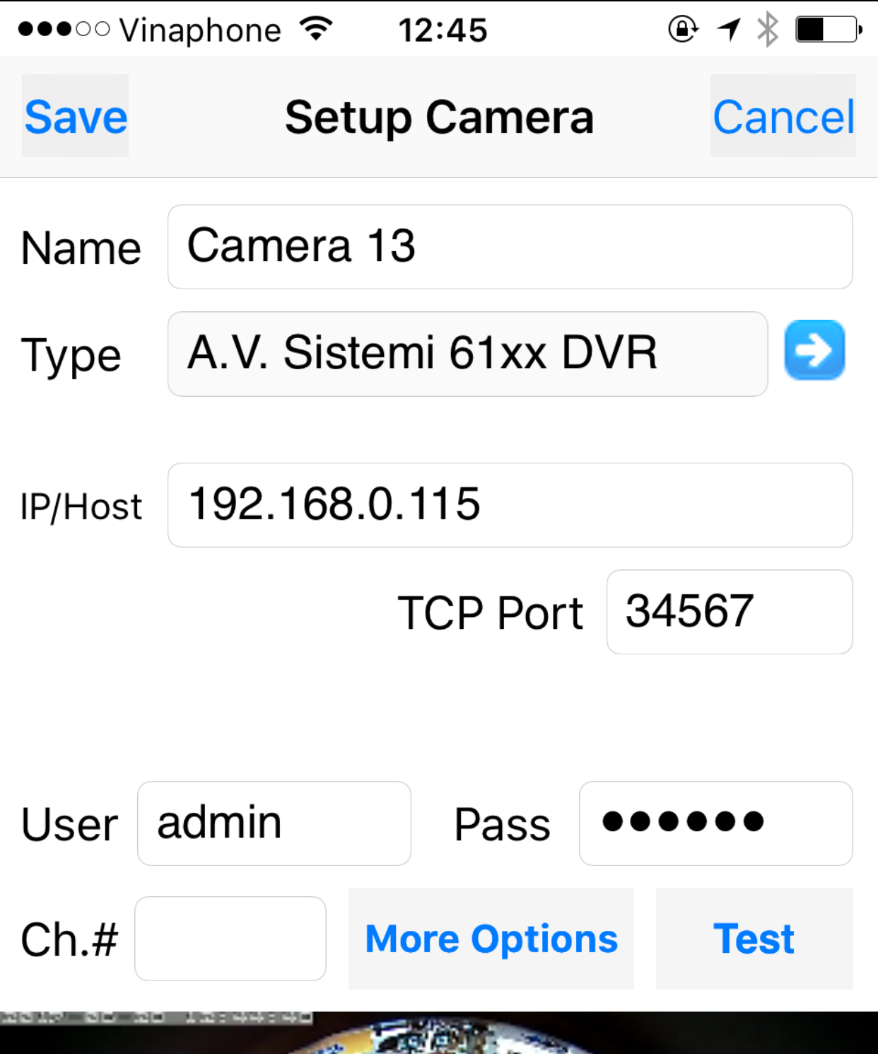

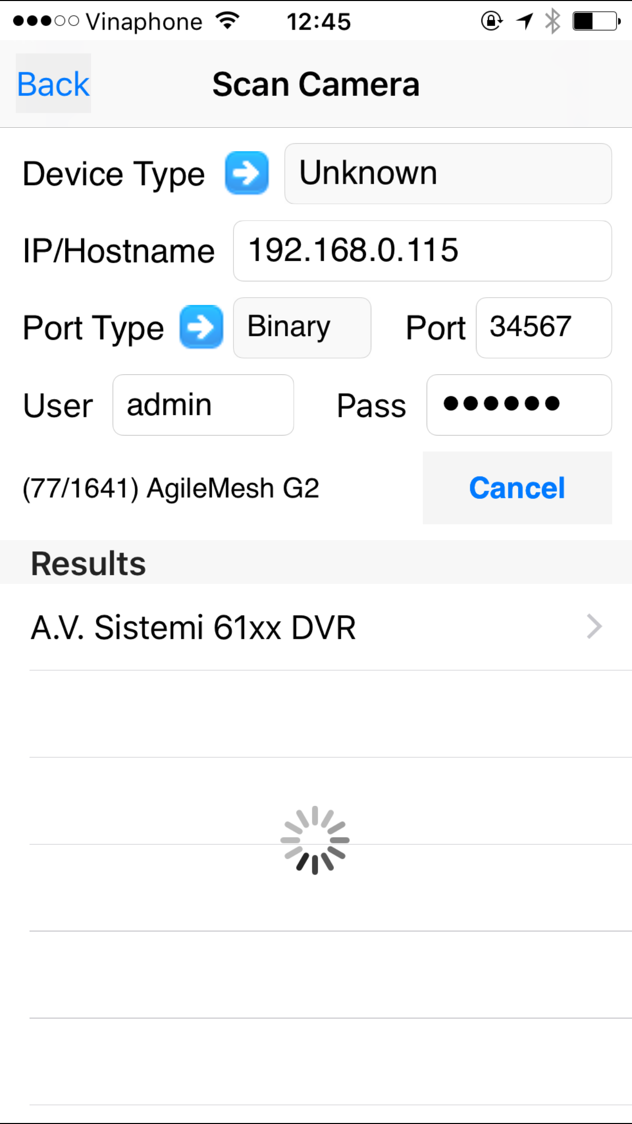

SUCCESS!
Based on the info above, i have able to view this 360 camera (same as what burton666 bought) to my iOS viewer app.
So i have all my cameras in one place. Of course the downside is that I can only view the stream as a circular blob instead of pan&tilt 360 video.
The iOS i'm using is IP Cam Viewer Pro, available for both iOS and Android https://itunes.apple.com/vn/app/ip-cam- ... 56416?mt=8
I don't think there is a HTTP stream or URL that can be accessed. But this is good enough for my personal use.
- IMG_0271.PNG (282.81 KiB) Viewed 39243 times
- IMG_0270.PNG (292.62 KiB) Viewed 39243 times
