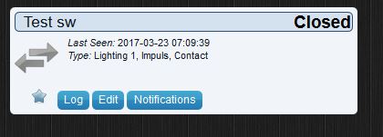

Am trying to add a LDR switch to my raspberry ans update one switch without success.
Connected my sensor to raspberry 2B following this guide http://www.uugear.com/portfolio/using-l ... pberry-pi/
When i run the python code "lm393.py" bellow:
#!/usr/bin/python
import sys
sys.path.append ('/storage/.kodi/addons/debug.tools.i2c-tools/lib')
sys.path.append ('/storage/lib')
import smbus
import time
import RPi.GPIO as GPIO
GPIO.setmode(GPIO.BCM)
GPIO.setup(4,GPIO.IN)
for i in range(0,5):
    print GPIO.input(4)
am getting the correct response (depends on LDR state):
pi@Rpi-2B:~ $ ./lm393.py
0
0
0
0
0
pi@Rpi-2B:~ $
- added "Raspberry GPIO" to Domoticz H/W
- added a switch as described in https://www.domoticz.com/wiki/GPIO
- exported the GPIO 4
pi@Rpi-2B:~ $ gpio exports
GPIO Pins exported:
   4: in   0  both
pi@Rpi-2B:~ $
BUT, switch is always at "Closed" state no matter what is the state of LDR (lm393)
test sw.JPG (18.84 KiB) Viewed 4093 times
What am doing wrong???????

Finally worked with those settings. Seems that i was not waited enough to see the switch toggle.
The problem is now that, with this method, we have a switch that receives EXTREMELY HIGH number of changes.
When am trying to see the log of this switch, it takes a lot of time to load.
Trying to find an alternative!!
