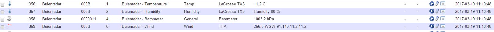

curious
Posts: 132
Joined: Saturday 02 April 2016 19:38
Re: Make Lua script only runs when device has changed
Post by curious »
The device that was created by installing the plugin is called "Buienradar - Wind"
[img]
[/img]
jvdz
Posts: 2445
Domoticz version: 4.107
Post by jvdz »
So guess you need to change this line to the appropriate device name like:
local sensoren= 'Buienradar - Wind'
