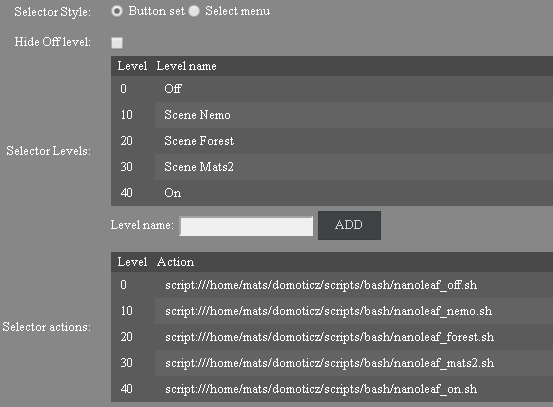

Post by MatsL »
Nanoleafs can be controlled similary as the Ikea bulbs by calling scripts. See here:
viewtopic.php?t=13882&start=40#p143476
First generate a API key (google translate)
https://technikkram.net/2017/05/nanolea ... ic-steuern
Then create scripts and make a calls to them from a domoticz selector switch
Examples below, replace IP and Auth_token with your own
On= {"on":true}
Off= {"on":false}
#!/bin/bash
curl -v -X PUT -H "Content-Type: application/json" -d '{"on":true}' http://192.168.0.218:16021/api/v1/AUTH_TOKEN/state/
Effect selector=
{"select" : "Forest"}
{"select" : "Nemo"}
and so on...
#!/bin/bash
curl -v -X PUT -H "Content-Type: application/json" -d '{"select" : "Forest"}' http://192.168.0.218:16021/api/v1/AUTH_TOKEN/effects/
