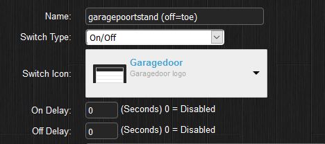

Works fine but Isn't there a solution where I could work with just one switch type? I mean where all information is integrated in one type?
As you can see in next image I already tried to add the 2 "On/Off" switches as slave devices in the "push on button" and this works,
the button becomes red once the door is open or closed and becomes grey in between the 2
BUT unfortunately I can't see the difference between open and close... both --> red

found this solution:
I'm using a virtual switch (selector --> 'blinds inverted') with an other set of icons (icon for 'open' and one for 'closed')
Below "devices" I found that the Idx of this virtual Switch is 204
I downloaded a garage switch from https://drive.google.com/drive/folders/ ... WdHV1Qxbm8 (unther 'D' you will find a garage door..)
Uploaded them in Domoticz with the help from this: https://www.domoticz.com/wiki/Custom_ic ... binterface
I installed a Fibaro Universal switch which detects if the door is open or closed (electrical contacts).
Below "Edit" from the On/Off switch that detects garage door=open I've put following JSON command by "On action":
"http://ipadresDomoticz:8080/json.htm?type=command&param=switchlight&idx=204&switchcmd=On"
idx204=the idx of the virtual switch.
Below "Edit" from the On/Off switch that detects garage door=closed I've put following JSON command by "On action":
"http://ipadresDomoticz:8080/json.htm?type=command&param=switchlight&idx=204&switchcmd=Off"
Hope this helps..
