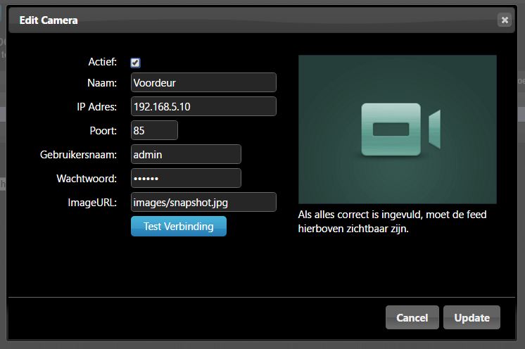

Uniview camera's can be added with these settings. Note that the snapshot must be accessed at port 85, which differs from the normal port.
Snapshot function must also be enabled in the camera. UNV recorders don't support this, only the camera directly.
