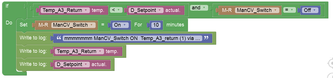

But this works for me:
Compare with constant.PNG (16.26 KiB) Viewed 2786 times
Temp_A3_Return comes a Fibaro FGBS001 with DS18B20 sensor
That was before I discovered the Thermostat type.
Now I use this:
Compare with dummy.PNG (30.55 KiB) Viewed 2786 times
D_Setpoint is a Dummy of Thermostat type
With this simple Blockly I control the underfloor heating of my whole house in a comfortable way.
Hope this helps
