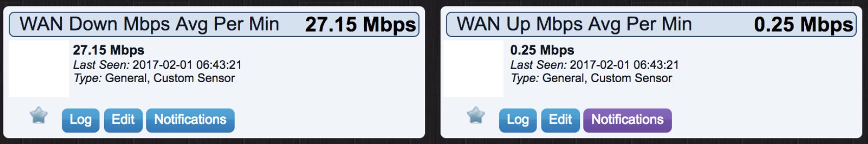

Hey Folks,
This is a bash script I wrote for getting the last minutes bandwidth information from pfsense and loading it into Domoticz.
Steps:
1) Go to this url on your pfsense box: https://pfsenseip/services_snmp.php
2) Tick the box to enable snmp and set the "Read Community String" to: "public" then scroll down and bind it to the LAN interface and press save.
3) Install requirements on your Domoticz server: apt-get install snmp bc
3) Fill in everything in the script except for the "waninterfacename"

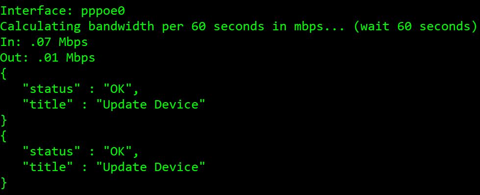

3) Run the script like this: "./update.sh list" and you will get an output looking something like this:
vtnet0
vtnet1
enc0
lo0
pflog0
pfsync0
pppoe0
ovpns1
In this case my wan interface is called pppoe0 so what is what I would enter in "waninterfacename" in the script (go ahead and fill the script with the name of your wan interface).

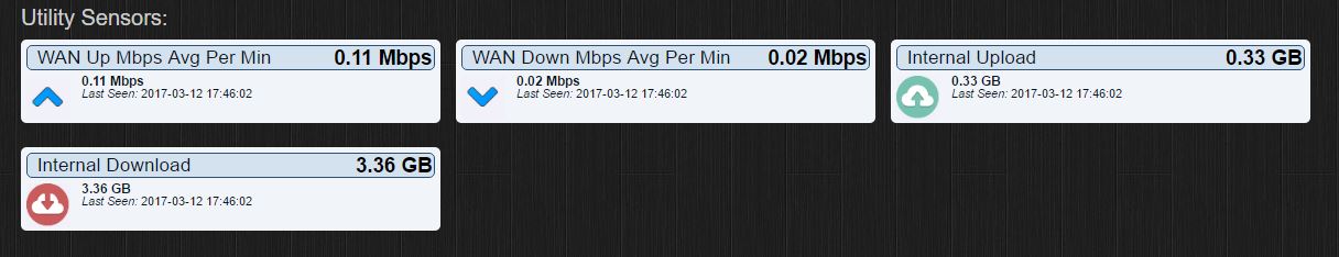

and this icons
They look like this

getting error
++ awk '{ print $4 }'
+ wanoutkb2=869273840
update.sh: line 47: ("2653134149"-"2652444641") / 60 * 8: syntax error: operand expected (error token is ""2653134149"-"2652444641") / 60 * 8")
++ bc -l
+ inbits=
++ bc -l
++ echo 'scale=2;  / 1000000'
(standard_in) 1: syntax error
+ inmegabits=
update.sh: line 49: ("869273840"-"868626335") / 60 * 8: syntax error: operand expected (error token is ""869273840"-"868626335") / 60 * 8")
++ bc -l
+ outbits=
++ bc -l
+ outmegabits=
++ bc -l
++ echo ' > 2'
+ echo 'There was a problem getting the data'
+ true
+ echo
I hade to edit the script a bit
# Do math for Mbps
inbits=$(echo $((($waninkb2-$waninkb) / 60 * 8)) | bc -l)
inmegabits=$(echo "scale=2; $inbits / 1000000" | bc -l)
outbits=$(echo $((($wanoutkb2-$wanoutkb) / 60 * 8)) | bc -l)
outmegabits=$(echo "scale=2; $outbits / 1000000" | bc -l)
