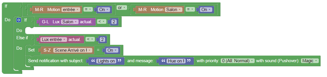

I would like to know why this is doesn't work :
Thank for your help : )
Block Hue + Fibaro eye

Re: Block Hue + Fibaro eye
1st reason: You cannot nest "If" blocks in Blockly
2nd reason: You must have at least 1 "else if" if you use the block with the blue symbol. For a single If-do, use the other block.
Try re-constructing using If - Else if.....

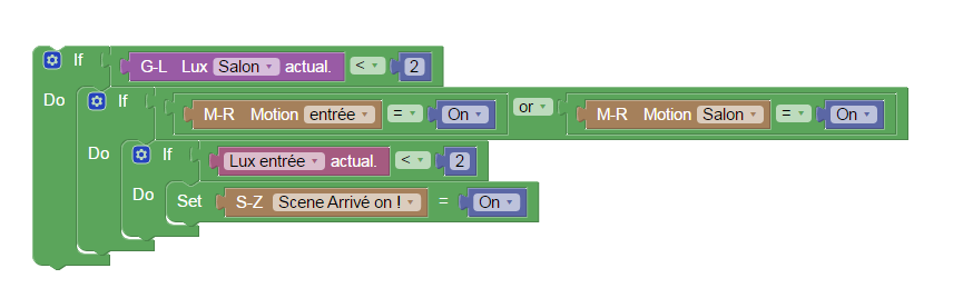

Thank you a lot, this one is working :
how to avoid reactivate accidently motion on when I leave home ?

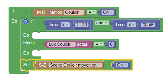

2nd question :
Why the time doesn't work : scene is on at 20:08 ?!
Thank you
Thank you
- Sans titre5.png (18.75 KiB) Viewed 1507 times
Hi, you still have nested blocks. Also the construction has empty sections. Here is an example that works and is constructed correctly:-
I use the timers in the Auto switch to control the active periods. It can be easier than dealing with the blockly times.
As Domoticz ends the day at 00:00, then your time blocks should use "Or" instead of "And".
Does that help?
Does that help?
Thanks you for reply
I do not understand what nest mean?
I will try your sample tomorrow.
Thanks a lot for your patience
Nested:- "If" block in another "if" block.
