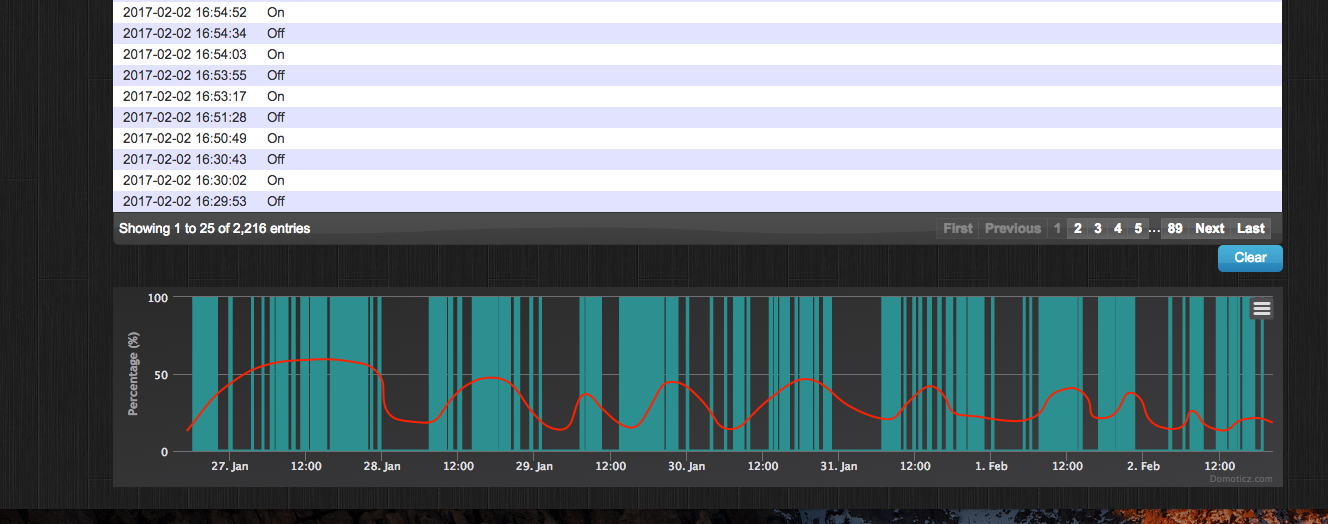

Is there any way to get average metrics from say a motion detector:
Motion detection
Motion detection
Screen Shot 2017-02-02 at 19.07.52.png (259.29 KiB) Viewed 973 times
The picture above shows absolute motion ON or OFF but over periods of time a bit less granularity could be useful, more like a busier times and less busier times. The red line hand drawn over it is more or less that.
If this is not really major need, is there a way to get from Domoticz internal DB (or whatever it uses) read values say from last hour and then calculate the average in LUA for example?
I guess what I'm trying to find out is stats rather than time series data. Any suggestions?

... is there a way to get from Domoticz internal DB (or whatever it uses) read values say from last hour ...
Sure! - That database is easily accessible. But you will obviously need to have the "sqlite" package installed, to provide you with the needed commands.
The query to retrieve the data can then be executed directly from the command line as follows:
MyDeviceId=51  # THIS IS THE INDEX NUMBER OF THE DEVICE
MyStartTime=`date -d '1 hour ago' "+%Y-%m-%d %H:%M:%S"`
sqlite3 /home/pi/domoticz/domoticz.db "select nValue, Date from LightingLog where DeviceRowId = $MyDeviceId and Date > '$MyStartTime'"
Please note the "backtics" surrounding the entire command string on the second line above. And also be careful to get all the embedded single and double quotes correct!
In my case, as a result of recently having opened and closed a window two times, the output from my "Perimeter intact" switch was:
0|2017-02-03 12:30:22
1|2017-02-03 12:30:26
0|2017-02-03 12:49:40
1|2017-02-03 12:49:54
The first column represents the on/off state (where ON is denoted as '1' and '0' means OFF). And with those time stamps in the second column now available to you, the rest is pure mathematics...
I hope this will be of some help to you.
