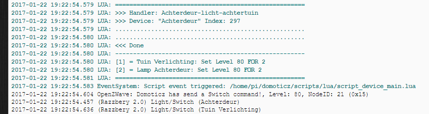

I have a script made that dim my garden light to 80 % when the door is opened and it is dark outside, works fine. But only the first device is activated.
    active = true,
    on = {'Achterdeur'},
    execute = function(domoticz, Achterdeur)
	    if (Achterdeur.state == 'Open' and domoticz.variables['DarkOutside'].value == 'True')
	    	then
	    	domoticz.devices['Tuin Verlichting'].dimTo(80).for_min(2)
	    	domoticz.devices['Lamp Achterdeur'].dimTo(80).for_min(2)

figured out that dimTo() does not support duration, but this seems not to be the problem.
Only the level of [1] = Tuin Verlichting gets set. and [2] = Lamp Achterdeur does nothing.
Anybody an idea?

I tried that, but no success. Still, only one switch gets updated.
And I don't want to switch them off, but dim them back to the previous level (5%)
Thinking about setting a user variable and make a time script that compares the last update time with the minutes past since the last update.
