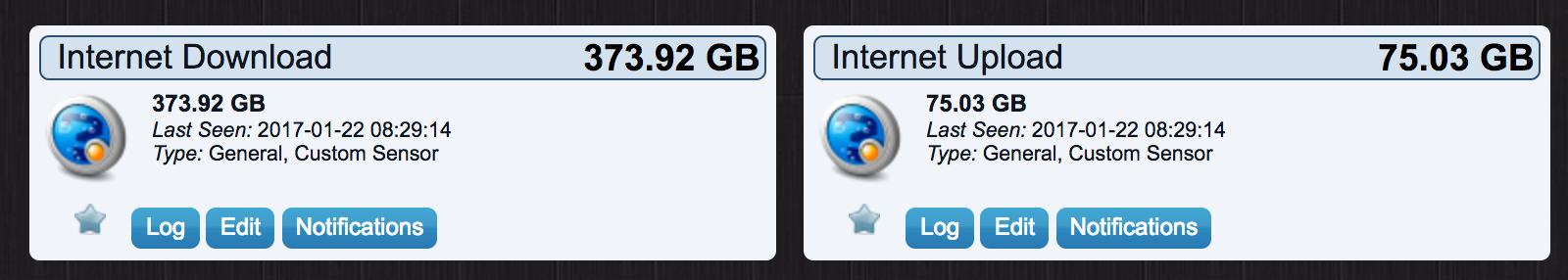

Linux Bash script for getting the monthly upload and download info from DD-WRT and loading it into custom sensor Domoticz devices:
Can set your own icons (I have nice up and down arrows). 8-)
Make sure you have bc installed, for Debian based systems the command to install it is usually: apt-get install bc
Screen Shot 2017-01-22 at 8.30.06 am.png (110.54 KiB) Viewed 11760 times
Screen Shot 2017-01-22 at 8.30.21 am.png (289.79 KiB) Viewed 11760 times

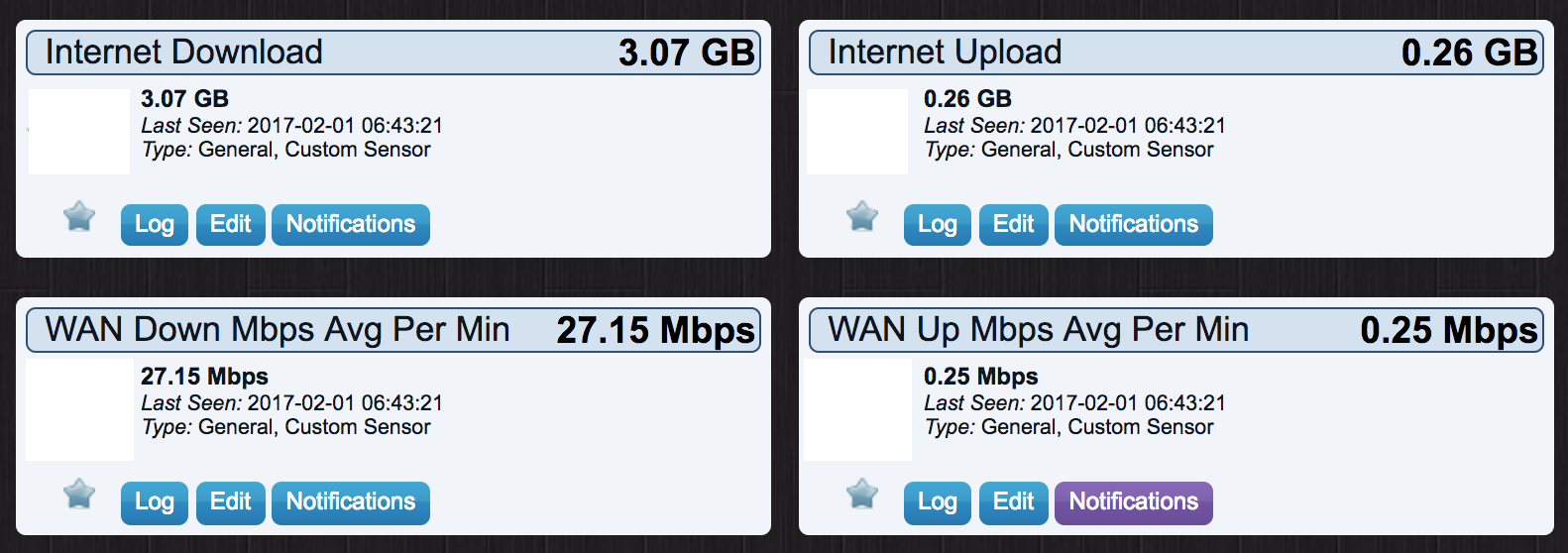

New alternate version which also calculates average bandwidth per minute for the WAN interface.
You need to set the IDX values for each device you create, for instance I have a custom virtual sensor in Domoticz for:
Internet Download
Internet Upload
WAN Down Mbps Avg Per Min
WAN Up Mbps Avg Per Min
You may also need to change the "routerinterface", mine is ppp0 for the WAN in DD-WRT.
Screen Shot 2017-02-01 at 6.43.33 am.png (173.91 KiB) Viewed 11597 times

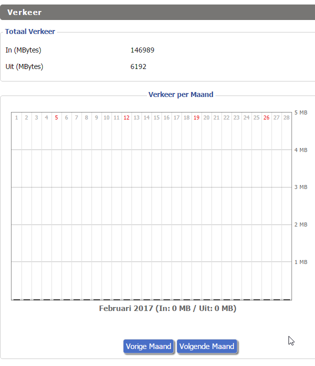

Hi ben how can I see what's my wan interface?
eth0 is my wan port assignment is that right?
it worked a month but my router hasn't data in februari.. but before everything is fine. :(

remb0 wrote:Hi ben how can I see what's my wan interface?
Hi remb0, you can identify the name of the wan interface by looking at this page on your DD-WRT router, change the IP to whichever your router is at:
http://192.168.0.1/Status_Bandwidth.asp
In regards to no data in February, it's possible you are using a different date format to what we use in Australia. You will want to check the output of these commands in the linux terminal and see if they match your date format (and alter if necessary):
date +"%B %Y"
date +"%m-%Y"
See here in getting the data from the router, it uses the current date as a variable
http://{$routerip}/ttgraph.cgi?{$dayandyear}
You can see how they are used in the script.
It's also possible your script isn't running automatically on system boot or isn't started?
Cheers
Re: DD-WRT Internet Usage Script
Posted: Saturday 11 February 2017 13:37
by remb0

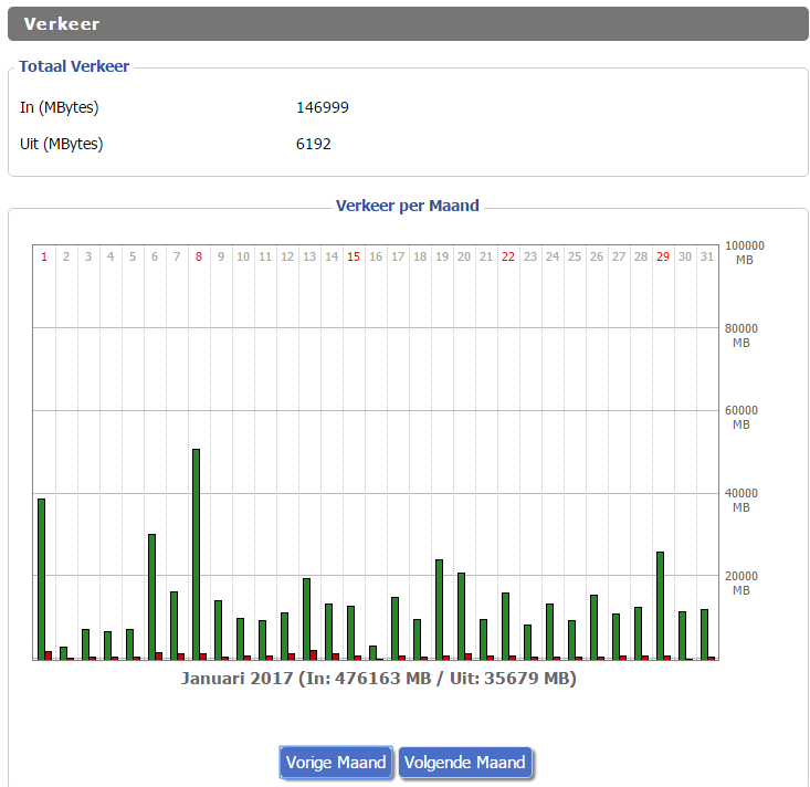

thanks ben! but I think the problem is not in the script. see my screens
2017-02-11 13_34_48-Router (build 31277) - WAN Status.png (17.92 KiB) Viewed 11427 times
strange huh? Can't find the reason.

First thing that comes to mind is check the output of the commands:
date +"%B %Y"
date +"%m-%Y"
I'm guessing language difference? The script does a string match for the date on the DD-WRT page, if there is any variance in spelling or format it will not be able to fetch the data. Script is written assuming english language DD-WRT and Domoticz setup.
Posted: Saturday 11 February 2017 13:54
by ben53252642
Ahh yes, just saw your second screen... Looks to be a problem in the router.
