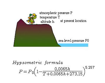

I am living near Madrid at an altitude of 625m. The air pressure giving by the sensor is the air pressure at this altitude.
To calculate the air pressure at sea level we must use the formula (see attachment).
So P0 = 1018.70 hPa which makes more sense.

I added this to my Python code:
altitude = 625 # My local altitude
pressure_sea = pressure_sensor / pow(1 - (0.0065 * altitude) / (temperature_sensor + 0.0065 * altitude + 273.15), 5.257)
