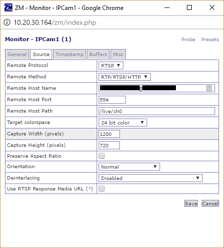

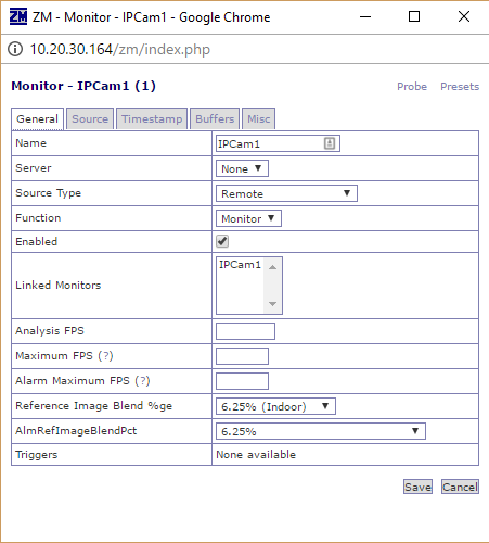

I think I found a better solution.
Using ZoneMinder. I installed ZoneMinder on the raspberry directly. Configured the cam in it and then, in domoticz, I use the feed from ZoneMinder instead of the cam.
Works pretty great!

Sure!
I've installed ZoneMinder on my raspberry:
https://wiki.zoneminder.com/Raspbian
Then, in ZoneMinder, I was able to setup my camera
After that, you configure your camera in Domoticz
viewtopic.php?f=35&t=7200&p=116443&hili ... er#p116443
No credit, I just picked parts on the Internet :)
Good luck!

Where did you get this "Remote Host Name"?
godinperson
Posts: 26
Joined: Saturday 06 May 2017 0:23
Re: Almost every camera works with this solution even RTSP
Post by godinperson »
Oh, I forgot.
remote host name is username:password@IPADDRESS and the remote host path, I found it on :
https://www.ispyconnect.com/sources.aspx
