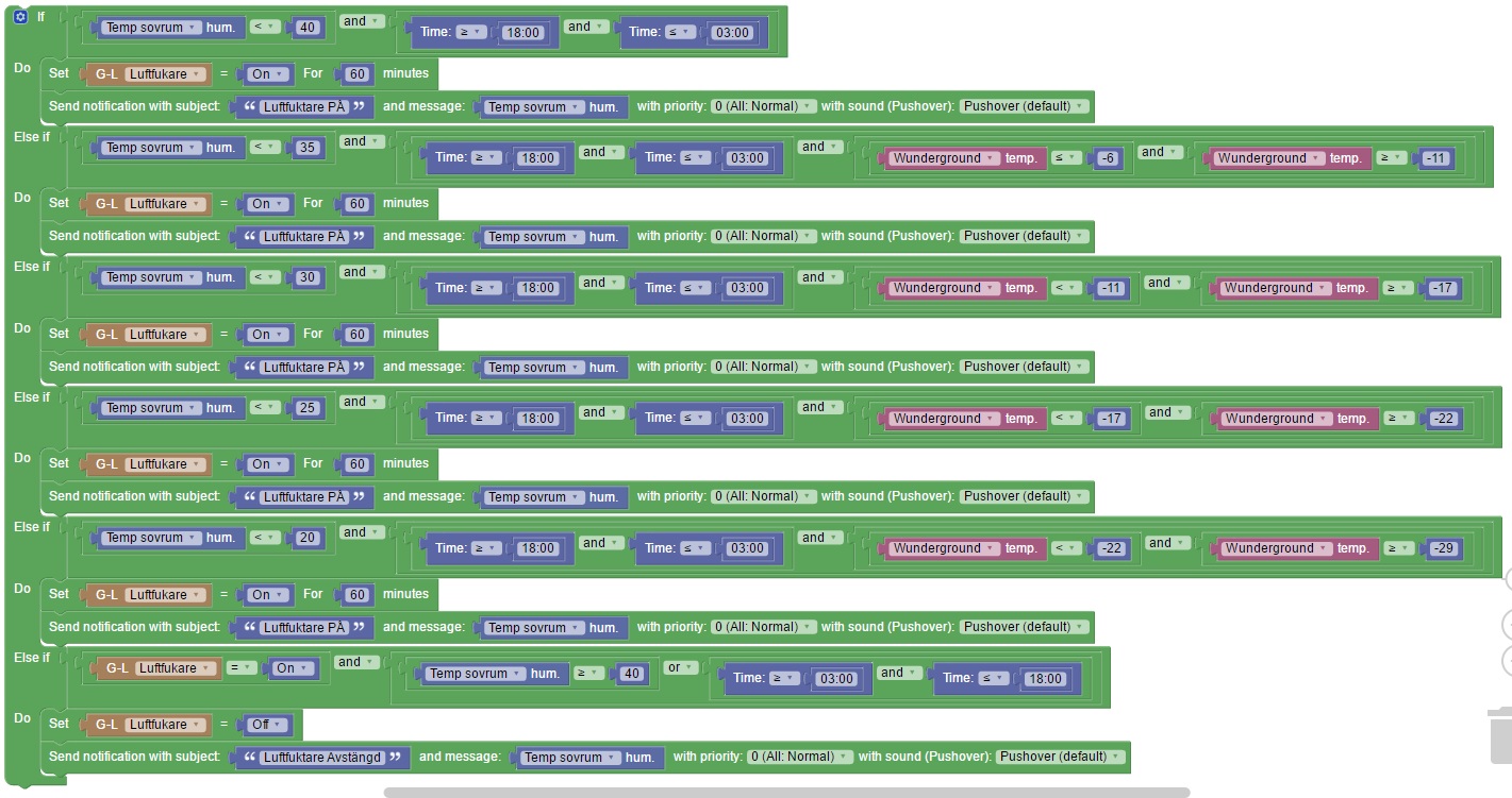

Hi everyone,
So I made this event in blockly that worked correctly yesterday. It basically turns on a humidifier in our bedroom based on outside temperature and current relative humidity in our bedroom. If it's colder outside it will only run until RH is around 15% (cold as in -25 to -30). If, on the other hand its more like -2, it will run until the humidity is at 40% or higher.
Does anyone see what I'm apparently missing?
When I get a reading in the log from my thermometer in the bedroom nothing more happens in the log. It's as if the if statements in the blockly never become true, but I just can't see why.

What am I missing? (blockly for humidifer based on RH and outside temp)

Re: What am I missing? (blockly for humidifer based on RH and outside temp)
Fixed it myself, I don't understand how it could work yesterday, maybe because I tried it after midnight? I fixed it by adding an or block with two comparisons of time. One checks if time is between 18:00 and 24:00 and one checks if time is between 00:00 and 03:00.
Before I made the change the script wouldn't fire, since 18:00 is never < than 03:00. Duh. !
If you have more than one thing that relies on these time conditions, it can be usefully to create a virtual switch that turns on at 18.00 and off at 03.00.
Then you can just query that switch in any blockys or scripts. It also means that if you want to change the times at some point, you just change one timer, not lots of scripts.
