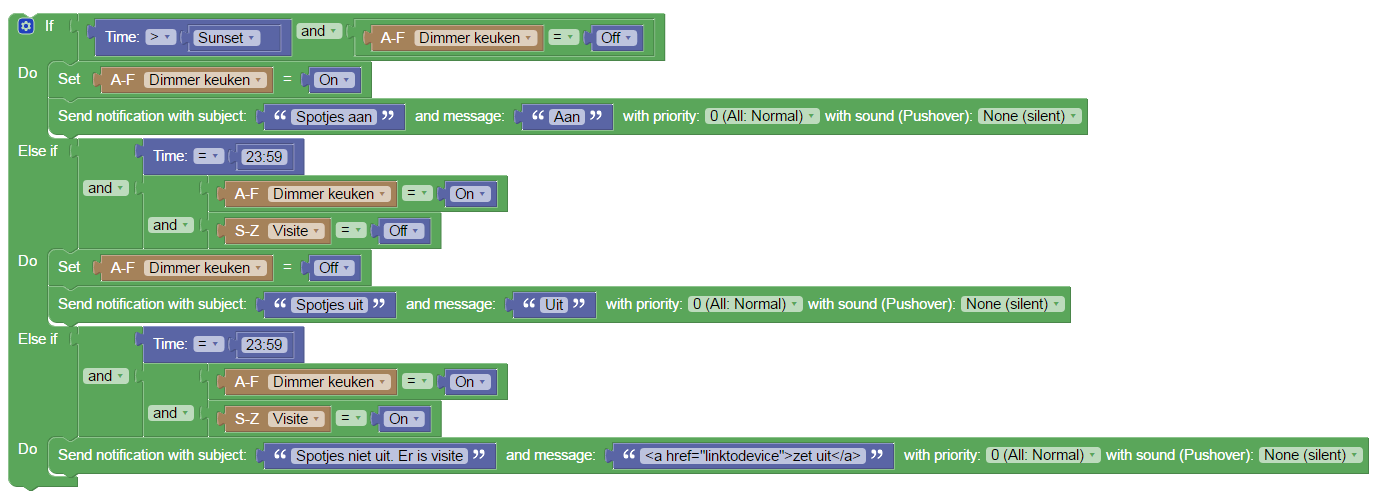

Does anyone know if it's possible to send html with a blocky notification?
I've created a blocky event which turns a few lights on at sunset and turn them off at 23:59. There is an exception if the virtual "visite" switch is turned on. If this is the case, I would like to send a notification which allows me to turn the lights off by clicking a "turn off" refers to an URL. Not clicking a URL itself.
The Pushover manual describes that there is a HTML 1 parameter, but I can't figure out if this works with blocky in Domoticz.
Thanks,
Dennis

Here I was looking for. I tried to adapt by adding 'html' with comma and + to the key and user field. Both were not working. Maybe something for the next domoticz version?
