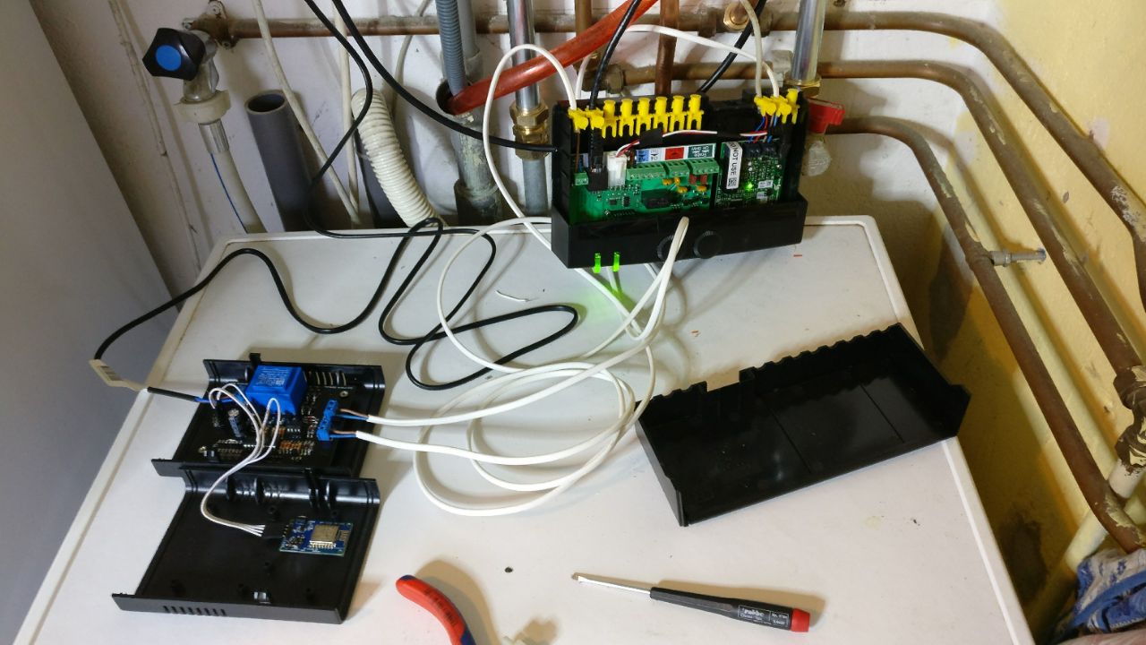

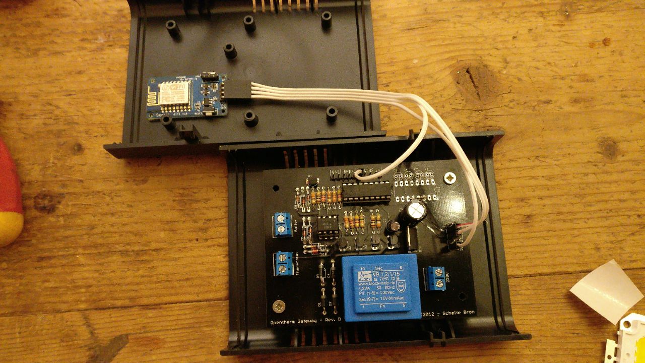

Update: I got it all working...see pics of the setup..
Some notes to consider: The ESP-12 wifi to serial module sometime doesn't boot. The blue led keeps flashing when I power op the OTGW. When it's started it seems to work just fine. No connection drops or failures untill now
I had to drop the voltages on the gateway itself to VR=1 strangely enough. All other positions gave me a lot of error 03's
