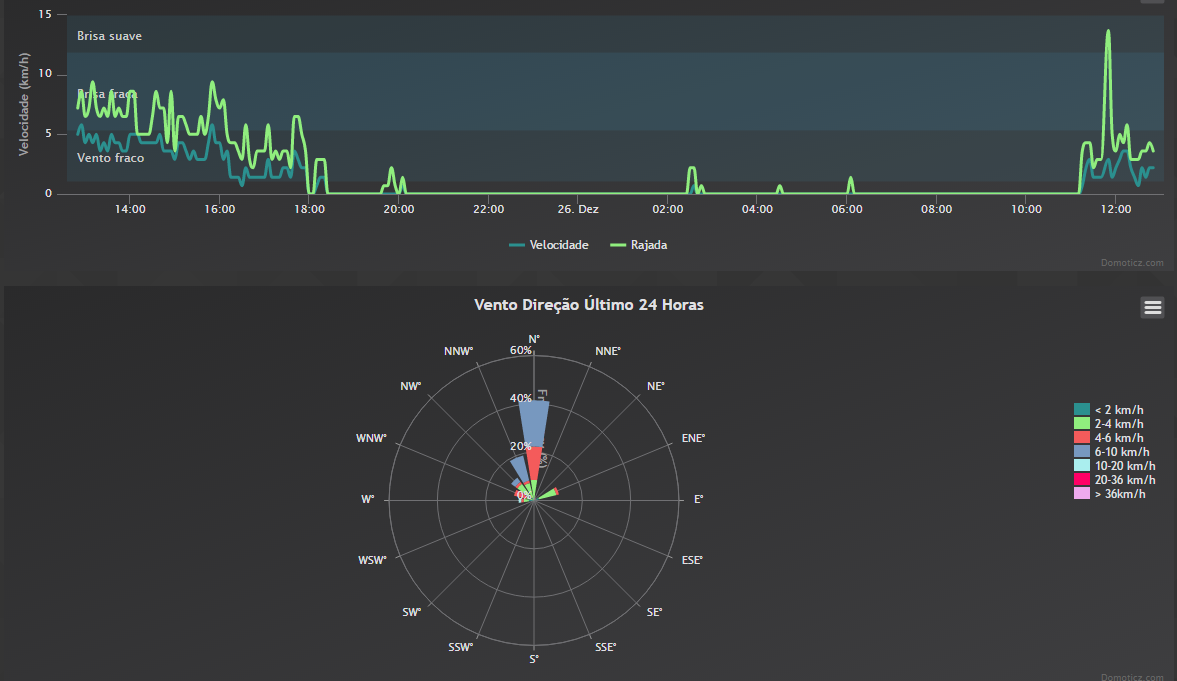

I'm having some trouble setting up my weather station alecto ws-3500 with Domoticz V3.6235.
I have the lastest firmware R45 on my RFLink gateway connect over USB to my Rapberry Pi3.
The problem is that the wind direction don't show up correctly on my domoticz, it does show wind from South has you can see on the picture bellow:
The second problem it's on my domoticz dashboard... when i marked up the wind direction has favorite, autommatically shows up a new card on my dashboard with the same name has my wind direction sensor that only shows a temperature of 0º, the same value is also show on the wind direction card saying Child: 0º
Don't now how to fix this two problems.
My wind sensor is calibrated to North, and i have done what says on the instructons to calibrate the wind direction point to north, hold the sensor point to north and the put the batterys on the sensor and wait until it blinks 3 times the led.
Over the LCD i do get wind direction correctly, but on domoticz i don't.
Don't now what to do to fix this, dont now if this is a bug on domoticz or a problem over RFLink gateway.
Any help would be appreciated.
Thanks in advance

I do have my alecto facing the right direction. Had to point it to North direction next had the sensor needle locked pointing to North and the last thing was to put the batteries and wait for the led to blink 3 times, done this i know that the sensor is calibrated to North in my home.
My problem is that in domoticz i never see the South beeing displayed on the graphic chart when i have winds from South like i'm having all this week...
If i look over the LCD console that came with the alecto i can see that the wind direction is showing it from South... but domoticz only shows West....
Really dont understand why this is happening.
Today i have done another reset to the sensor and recalibrated to North for the 10 time and once again when it was supossed to show Wind from South is showing wind from West.....

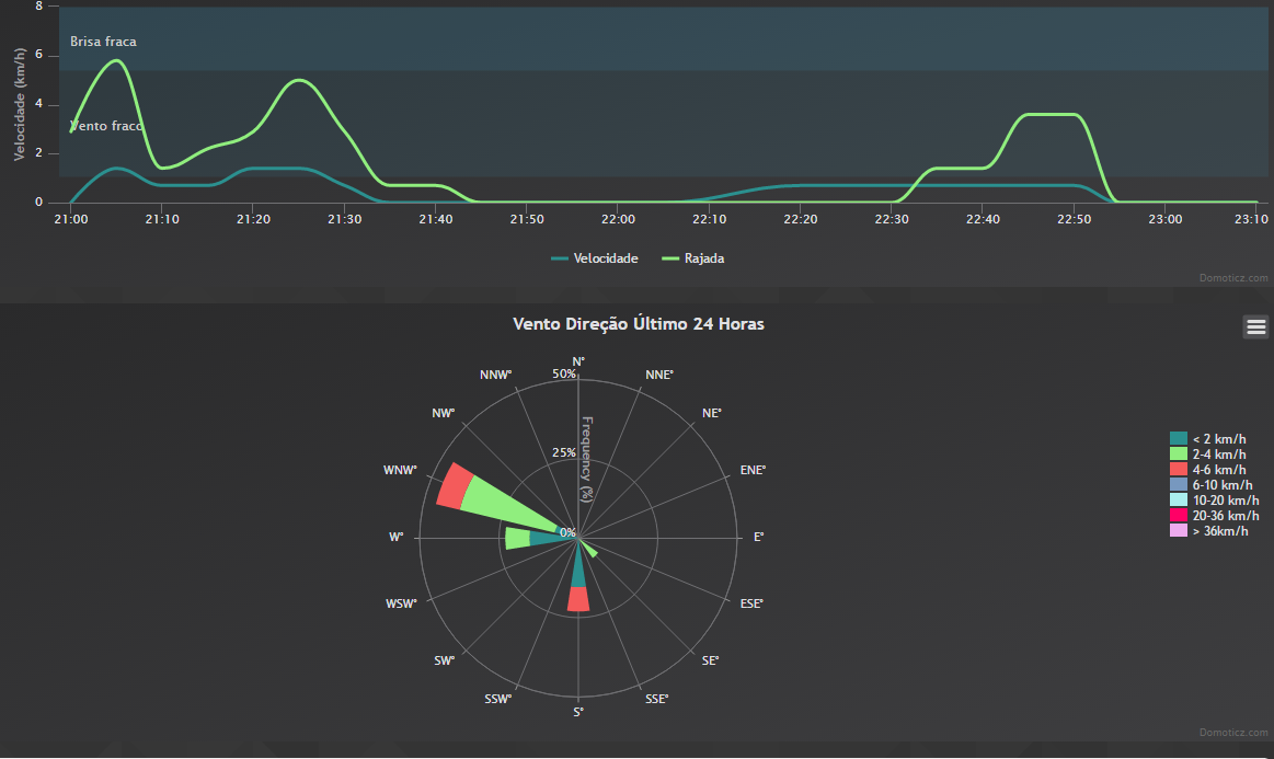

Problem not completly solved.... :-(
I do get wind direction from South but it's not totally correct.
Today the wind is from South and my station on domoticz says the wind is from 90% off the time West when it should say South.
Can the programmers see if there's a "bug" over the code for this weather station using the RFLink????
Or could the programmers off domoticz look over the code for this weather station on the next firmware release that could fix this problem ??
