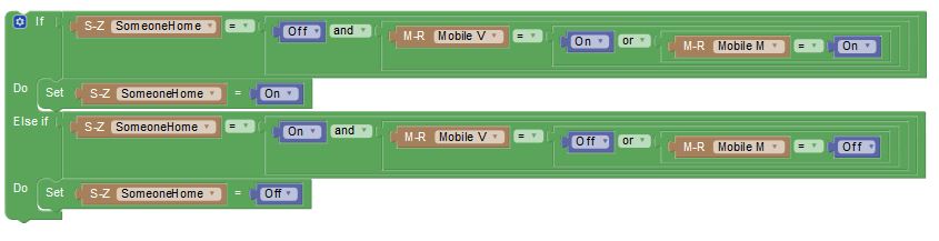

Hi, I've made a blockly script, but dosen't work.
Any help would be greatly appreciated.

I think you have them boxed / bracketed incorrectly.
I'm on my mobile at the mo so can't to a proper example but will give it a go;
You have :
If (someone home=(off and (m =(on or (v= on))))
You need :
If (((someone home=off) and ((m =on) or (v= on))))
Hopefully that makes sense. :)
If not I will try and do a proper blocky example tomorow if one has before.

Also, in your else if statement, I think you want
If sh is on, and BOTH v and m are so( both are away)
Set sh off. At the mo you have an or there.
So if you are both home, and one of you goes out - It would set someone home off

Think this is rogt.
