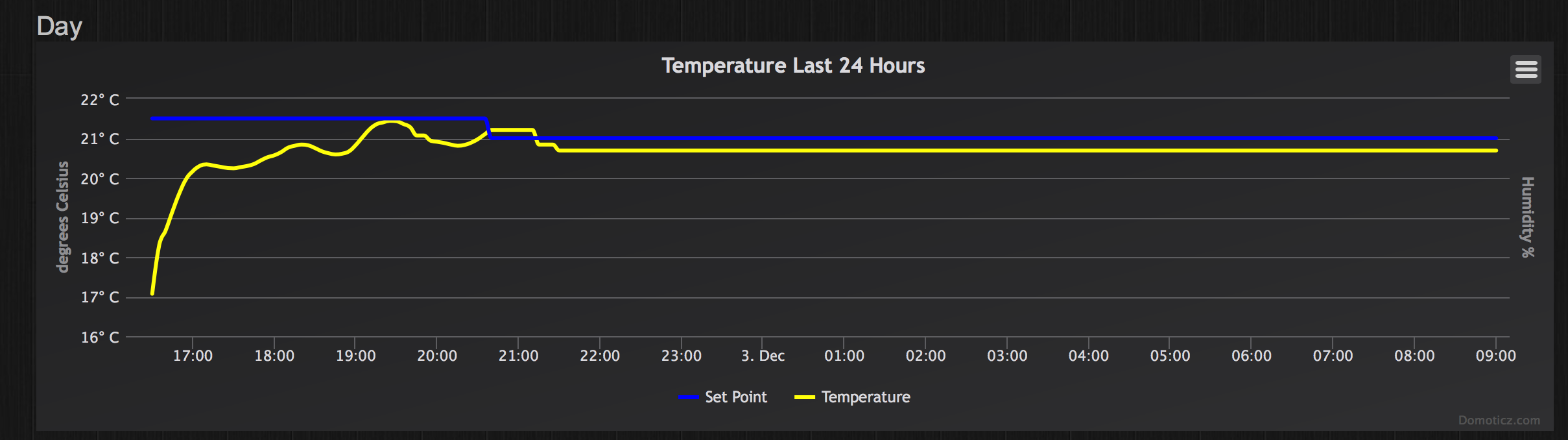

A lot of times, the temperature sensor is not working quite well.. It seems like it's just dies when I set the Thermostat to 'away' (in graph below, this would be around 22:00) and it doesn't wake up when I set it back to 21 degrees (at 7:30).

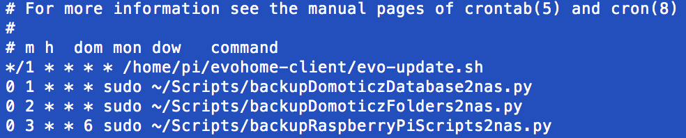

This script is also present in my crontab:

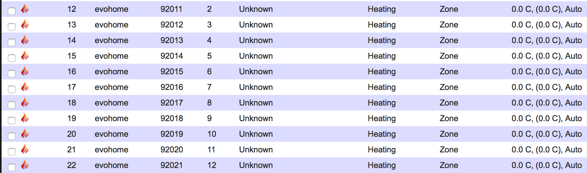

Well, talking about unused evohome devices. I removed these:
Screen Shot 2016-12-05 at 18.59.46.png (191.4 KiB) Viewed 1095 times
Maybe I've shouldn't have done that :). Added them again. Let's see how this goes. Otherwise I should have a look at your C++ stuff ;).

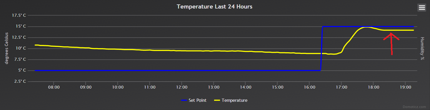

At 18:15 I set the thermostat by hand (read: I turned the round thermostat) to 5 degrees. In domoticz, you can see the temperature sensor doesn't get updated, and the 'set' temp also isn't moved back to 5 degrees.

I made a mistake placing the evo-update.sh entry in the pi-user's crontab file :|.
Should've used
sudo crontab -e
instead..
