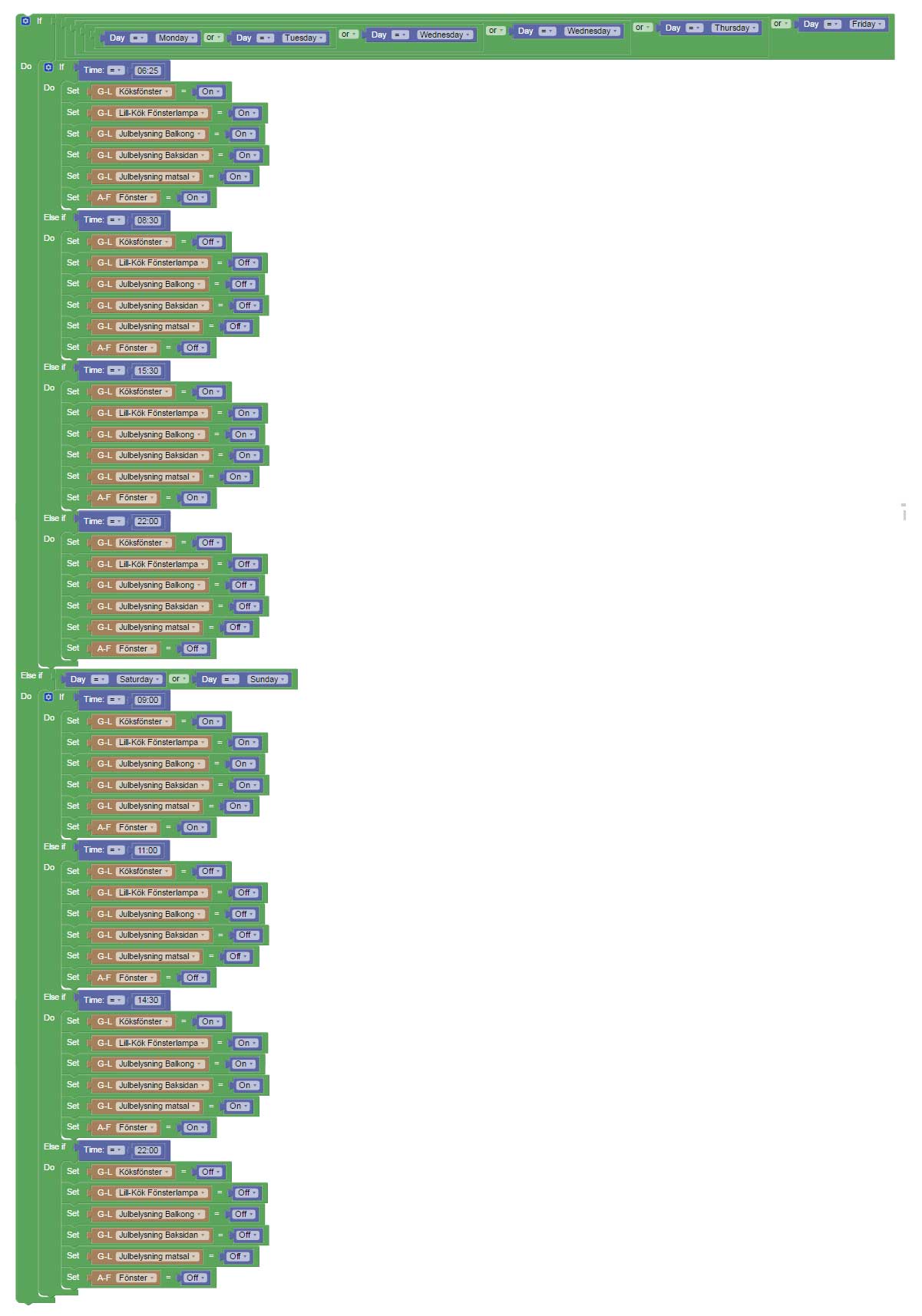

This blockly event is driving me mad. It's supposed to turn lights on in the morning and evening, and turn them off in between and during night. Differnt times week vs. weekend.
If i activate this all lights turn off and if i manually turns everything on everything turns off again after a short while. Can anyone see any galring mistake I've made... i guessit could be done smarter but this should work (in my head at least).
A quite tall image in this link
https://bertholdsson.com/weekly_schedule.jpg
Same image as in the link above

perhaps do a check in the firstrow.. after or before time
If x = on the y off
Or if x off then z on

I may be missing something, but would it not be easier to put all the lights in a group, and then set timers on that group?

sion wrote:I may be missing something, but would it not be easier to put all the lights in a group, and then set timers on that group?
+1 was going to say the same thing! Please use groups and timers for this. Will save you lots of time when adding or removing switches later on.

Or start scripting, would be much better for stuff like this.
Like check every lights status before sending command instead of just sending commands to all lights.

Thank you all. i tried your ideas and grouping made it all much more readable but I think I'll go with the scripting path. As i understand i can use Python and that should make it more easy to program .

What I found is, that it's not a good idea to put only days of the week in your if statement, because it makes your event execute every minute, because the if statement is true every time. It's better to make a switch called "Weekday" and a switch called "Weekend" or something. And put a timer on those switches. Then change your blocky to "If weekday = on" or "If weekend = on"

Slinkos wrote:What I found is, that it's not a good idea to put only days of the week in your if statement, because it makes your event execute every minute, because the if statement is true every time. It's better to make a switch called "Weekday" and a switch called "Weekend" or something. And put a timer on those switches. Then change your blocky to "If weekday = on" or "If weekend = on"
You could use one switch, if it's on it's the week, or if it's off it's the weekend. However, as it will always be either one or the other - Will the script not still run every min to check the times?
Either way will work I guess, but Is there any advantage to using a script rather than a timed group for this? Or just preference.

Just going back to the Blockley. Use the timers method and groups and remove the "nested" "If" structure. Now that it is much simplified use "else if" to rebuild. Then I am sure it should work. I have never managed to successfully get a nested "if" structure to work.

If you go into the "Timer" function on a standard switch, you will be able to build a schedule there. Then use the switch state in a script or Blockly as part of an "if" condition.
I use several "Dummy" switches as timers.

create a group from the domoticz web interface on the groups / scene page. ( make sure it's a group as you want to turn them off too).
Add all your lights to this group.
Then on the main page, you will now see the group switch. Under this is a timer button. Next to the log button etc...
click on timer, and it will take you to a schedule page where you can set as many on and off times as you like.
Including specific to the day of the week.
I like the group method. It's easy to add a light to the group later on, and the original timers still stand.
I use something similar - I have all the light turn off in order at the end of the night If we are not home, to simulate some one going around the house "locking up".
You can do this with off delays in the group. ( you wouldn't want this for normal functionality).

Wow, this was neat. I had already a couple of groups and putting them on timer was exactly what i needed. Much easier than dragging blocks of blockly for this kind of simple repetive tasks.
