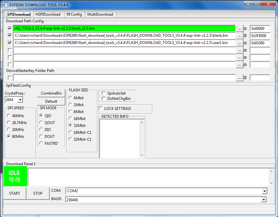

Well, had some time on my hands waiting for the rest of order to arrive so I thought I'd give the Adafruit HUZZAH ESP8266 a try. Worst case, I'd lose a few €'s/$'s or whatever currency. Hooked it up to USB using an 'FTDI Friend board'. Tried all sorts of flashing tools available, and ran into one problem after the next. Eventually tried the standard ESP8266 Download Tool v3.4.4 from here (https://espressif.com/en/support/download/other-tools). Downloaded ESP-Link v2.2.3 prebuilt binaries and went about my business...It all started off fine with lights flickering and progress indicators looking good. Got to 100%, closed apps and hit reset on the card....just a dim red light :( Not booting, couldn't access, bricked! Managed to get it back into 'programming mode' by holding down the GPIO0 button while using an older version of Espressiff's software found from this link (http://www.xess.com/blog/esp8266-reflash/) and the 'v0.9.2.2 AT Firmware.bin' binary. It managed to sort the bootloader and I was back in business :) But...I NEEDED ESP-Link, so time to try it all over again. Long story short, it all worked. The settings I ended up using are in the screenshot in case others run into the same issues or problems.
Screen Shot 2016-12-03 at 11.15.54.png (97.09 KiB) Viewed 8030 times
Connected to it using my phone (IP address not on my network), opened browser, changed the IP address to one on my network, reconnected and changed configuration a bit (fixed IP, pin assignments, etc.), added an 'Opentherm Gateway with LAN' in Domoticz (although no OTGW in place/connected) and started seeing data coming through on my terminal monitor. Looks like it might just work as a suitable WiFi device. Plus side is it is readily available in NL, works with voltage from 3.5V-6V, is reasonably well documented and configurable. Onboard LEDs make it easy to see LAN/Serial traffic flow too
