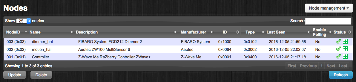

Thanks for the example. I am trying to get the setup to work, I have created a blockly script which should just do that, but nothing happens. I see that the Aeotec sensor switches to "On" when movement is detected. However, no lights. The dimmer is shown in the Hardware overview:
Screen Shot 2016-12-05 at 22.10.55.png (112.15 KiB) Viewed 4525 times

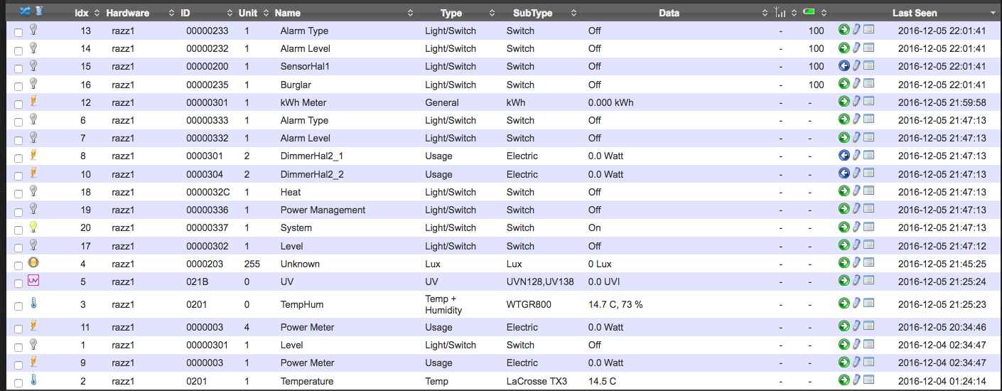

And this is my devices overview:
Screen Shot 2016-12-05 at 22.25.13.png (235.42 KiB) Viewed 4525 times
I renamed 2 devices which I thought where dimmers to "DimmerHal2_1" and "DimmerHal2_2"

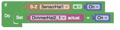

And here is the blockly script I created:
Screen Shot 2016-12-05 at 22.28.31.png (20.22 KiB) Viewed 4525 times
Whether I select Dimmer1_2 or Dimmer2_2, in both cases nothing happens. So I assume I do not have the correct devices selected as a dimmer.
How do I know which device belongs to which piece of hardware ?
Additionally; when I go into Control panel, select the dimmer and set a value higher than zero in 'current valies', the lights go on. So the dimmer itself works.

by mischa
DimmerHal2_1 and DimmerHal2_2 are the usage devices from the dimmer the give back a power usage reading in Watt.
The lighting bolt in front tells you that is a usage device. the ones with the light bulbs are your switches, you also see the UV, LUX and temperature icons.
I think that idx 1 is your light. if you put it on in the control panel. it should change in the device page (the light bulb goes on).
Extra tip; Make sure to give you z-wave devices a meaningful name and also the devices associated with that node before you add a new node.
This way you are sure wich devices are associated with a particular node. you can leave not used devices "set unused" or place a $ sign in
front of your device name to hide it from the switches tab, but you can use them in blocky.

Thanks again. I connected another Fibaro Dimmer 2 to the setup and fiddled around with it. It appeared I forgot to set the blockly event to active (DOH!). Now it works. At least, the light switches on when movement is detected. Nice ! Now to figure out how to set the timeout on the dimmer so the lights go off after 1 minute of no movement detection.... :D

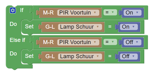

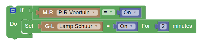

Re: Getting Fibaro dimmer to work
Posted: Sunday 11 December 2016 21:15
by mischa
Hi Andy,
Try this;

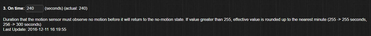

Make sure that parameter 3 of the aeotec sensor "On time" = 0 seconds.
Or you can do this, set parameter 3 to 240 seconds for example.
Change you sensor and light name accordingly.
Mischa
