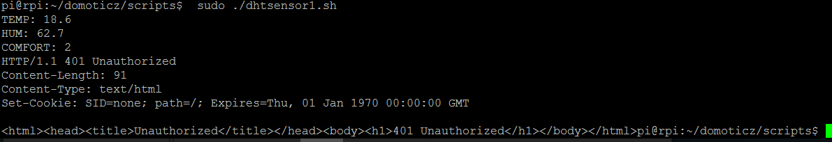

First thanks for your quick reply. Before I read your post i have tried next http://blog.briankmarsh.com/domoticz/ .

Running this one shows:
I hope you know a solution.
Thanks in advance!
Jan

After reading viewtopic.php?f=28&t=14383&p=105237&hil ... ed#p105237 I found a solution.
Jan
