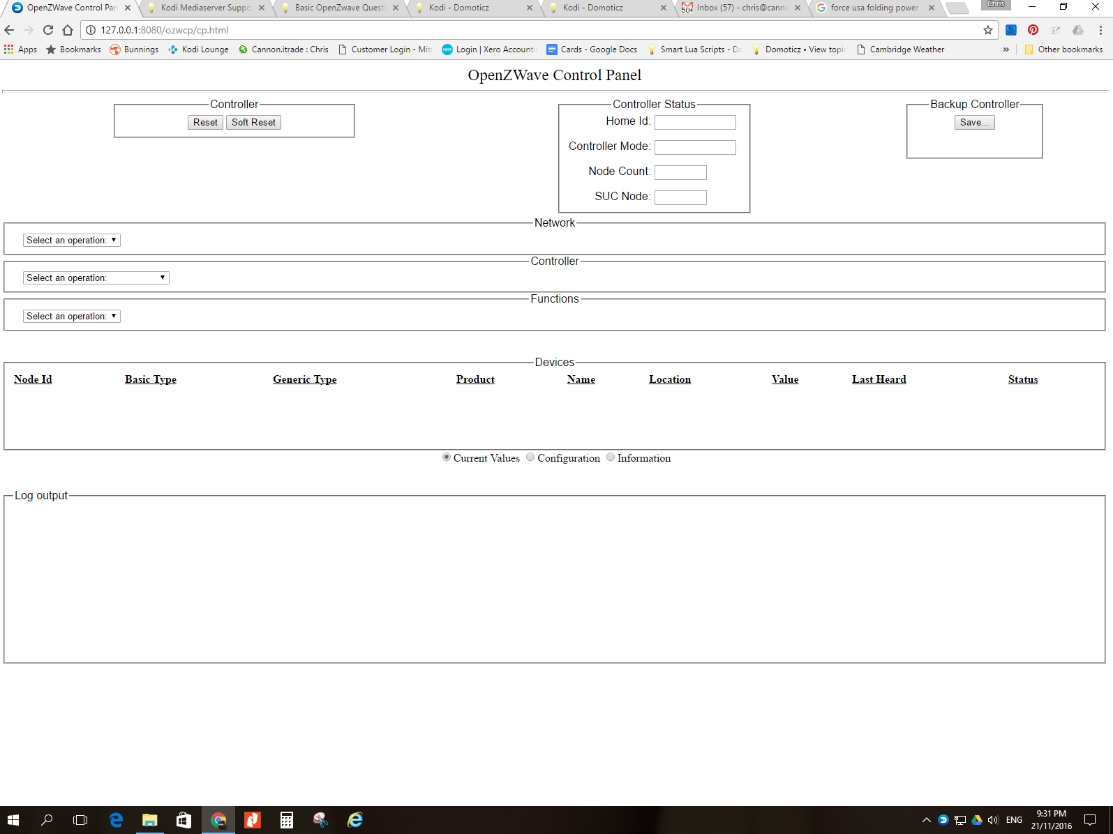

Then, once in OZWCP the screen is empty? Can you post a screenshot?
Re: Basic OpenZwave Question
Posted: Monday 21 November 2016 9:33
by Cannon

Yes I figured that bit out after awhile :) but still a blank control panel as in the screenshot

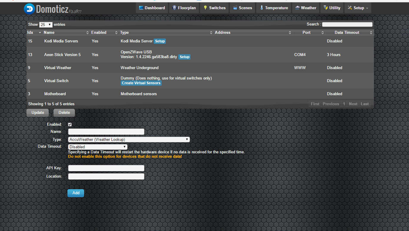

Can you post a screenshot from the domoticz hardware ??
Posted: Monday 21 November 2016 19:03
by Cannon
