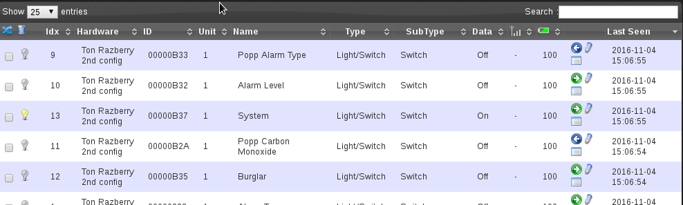

I'm trying to get a Popp CO Detector working... It works in the Zwave.Me software from the Razberry manufactor, but not yet in Domoticz.
There are hardly any Carbon Monoxide sensors on the market, so this is my only chance!
First try
No additional xml file, Z-wave working.
Domoticz devices screen shows a POPP CO switch
Question 1: I would expect a meter or sensor, not only switches, because Zwave shows a sensor displaying a value in mol/m3. Why is this?
Question 2: Off course, I can overrule it to be a readonly sensor, but not change it into a value measuring mol/m3 CO. Is there a way to do this?
Question 3: I would expect an on/off value, not a %. Why is this a %?

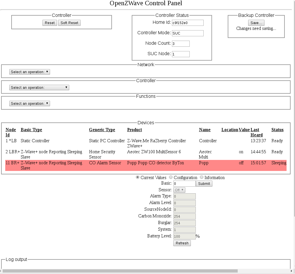

Strangly, the underlying OZWP software shows what I'd expect:
Question 3: Why does the underlying software shows the correct values/configuration, and Domoticz not?

Now I'm using the XML file given by the manufactor (see attachement), removed zwcfg_xxxx.xml, excluded and included the device.
Rasperry Pi3, Domoticz 3.5837, Aeon Multisensor 6, Popp CO Detector 7704.
Still the same problems... what's going on
