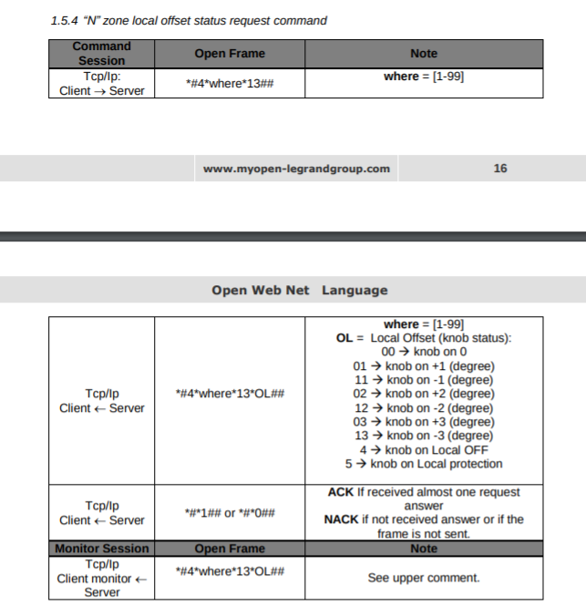

Today I have checked and it works very well, only one issue, when the thermostat is read I can not see the position of the local offset selector
There is a way to know the positions of the selector?

Hi Dino,
you are right, there are 2 things that have never been added:
- probe status (heating, cooling etc.)
- selector positions (temperature offset, OFF etc.)
I did a quick check and didn't find a good way.
The only quick way is to add 2 more text type devices with the information mentioned above.
I try to make these changes, let's see if it's okay ..

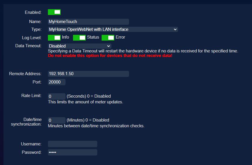

I looked aroud for such rescan, but I could not find it. Which is the field?
- Cattura.JPG (52.66 KiB) Viewed 1970 times
- Posts: 87
- Joined: Tuesday 29 March 2016 16:41
- Location: Italia
Re: OpenWebNet developing..?
Rate limit
- Posts: 38
- Joined: Thursday 16 February 2017 14:08
- Location: Italy
TY! I'm trying to set it at 30 minutes ...
