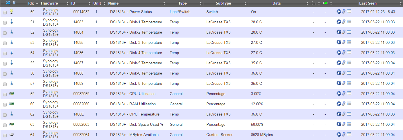

- Posts: 142
- Joined: Friday 21 October 2016 9:25
Re: HowTo: monitor Synology NAS
Here is the code I use for monitoring my DS1813+ running DSM 6.1-15047 Update 1. I do not have a disk installed in Bay7, so not monitored, but the rest are all working.
#!/bin/bash

Suggest running the following command from the command line on Synology:
snmpwalk -v 2c -c"your password" "your NAS IP" 1.3.6.1.2.1.25.2.3.1 (where items in " " need to be replaced with yours)
This will return the information needed to determine the correct OID to check disk space. Look for a entry like the following (assuming you want info for /volume1):
HOST-RESOURCES-MIB::hrStorageDescr.52 = STRING: /volume1
Where .52 is correct for my setup, it may/will be something else for yours (e.g. 31, 41, 51, etc.). In the script, edit the relevant lines with the correct OID, such as:
# Free space volume in Go
HDUnit=`snmpwalk -v 2c -c $PASSWORD -O qvU $NASIP 1.3.6.1.2.1.25.2.3.1.4.52`
HDTotal=`snmpwalk -v 2c -c $PASSWORD -O qvU $NASIP 1.3.6.1.2.1.25.2.3.1.5.52`
HDUsed=`snmpwalk -v 2c -c $PASSWORD -O qvU $NASIP 1.3.6.1.2.1.25.2.3.1.6.52`
HDFree=$((($HDTotal - $HDUsed) * $HDUnit / 1024 / 1024 / 1024))
Do the same type of check for CPU, RAM, etc.
My devices as attached.
- Syno-Devices.png (84.83 KiB) Viewed 7061 times

Hello!
I use the script and wiki instrucctions to monitor a ds414 and work fin. I searched the correct id for my devices but with the instrucctions of this forum was easy.
The problem is with the "counter virtual swith", in the device seccion of domoticz i see it with the correct values. But in "utility section" apears strangr dates and diferent in title and in the body of sensor. I don´t understand nothing
I use counter virtual switch
any advice???
and other question, i find the correct id for my 4 hdd. its posible to find the id for a usb device?
any advice???
