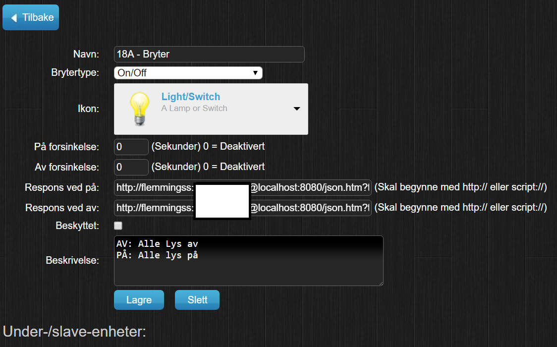

I have some wall-buttons connected to my RFXTRX443E that should turn lights on and off.
Like this:
ON:
http://flemmingss:PWD@localhost:8080/json.htm?type=command&param=switchlight&idx=36&switchcmd=On
OFF:
http://flemmingss:PWD@localhost:8080/json.htm?type=command&param=switchlight&idx=66&switchcmd=Off

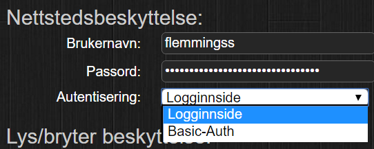

This works fine if i use "Basic-Auth", but if i change it to "logon page" it stops working in like 10 minutes or somthint.
the buttons on the wall works, I can see it in the log.

But the JSON url's works from my browser, phone ect (not localhost), also with "logon page"?
what can be the problem?
I don't want to use the "Basic-Auth" because it works badly with automatic login.

Disable authentication for 127.0.0.1.
