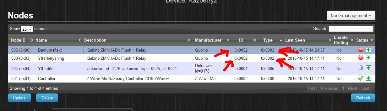

Pretty new to this, but I have had a Qubino relay to my outer-lightning. And today i included a new realy to my bathroom lightning.
The new relay was included, and worked one time, then both of them stopped working. I have tried the usual with healing network, add remove node, include exclude. But the feeling is that they cant be in my network together.
I saw that they have got the same id and type in domoticz-hardware. Can that be an issue? or is it standard if the relays are same type?
Thankful for help... //Richard

Id & Type are product related and correct.
What version of Domoticz are you running (standard question!)
Loook in your Config directory for a file called zwcfg_0x.......xml
Look in that file for Node 003 and 006
The end of line must contain
query_stage="Complete"
If not (or anyhow)
Stop Domoticz,
remove the whole section from
Node id="3" ...up-to.../Node
Do the same for Node 6
Restart Domoticz
B.t.w. ... your node 004 is also not correct

I suspect he is running an old version, as the manufacturer for node 4 is already known (Telldus, TZDW-100 Magnet Switch)
Plz upgrade to the latest beta version
Exclude node 4 and include again

My version is (was) 3.5769 i update when Domoticz tell me there is a new version, Don't know why my Telldus magnetsensors don't show up correctly, but it is working correctly whn my door is opened/closed.
I will try to incllude/exclude again and see what is happening, thanks for your help, now I have something to work with :)
