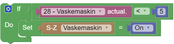

Why don't this work?
IF watt-utilety < 5
Set dummy-button = on
when the watts is above 5 nothing happening, when the watts is under 5 nothing happening.
why?
This is shat I want to do:
If the watts is above a value (5) a dummy should go to "on"
When det watt is under a value (4) for 10 minutes set dummy to "off".
Is this posible?
IF watt-utilety < 5
why?
Is this posible?

Here it is:
Derik
- Posts: 1605
- Domoticz version: BETA
Re: "If watts" dont work? (blockly)
u have to use mutiple options with this type of blockley. [ use the other or make more blockleys with the button ]
Then you have check in your blockley, if vaskemaskin = off ,after x you want, set vaskemaskin on

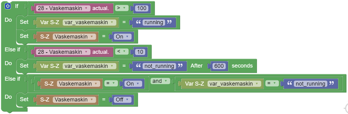

maybe this will work?
I hopeEvelen wrote:hmmm.
Let me now...
I need some counters in blockley to..

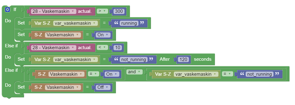

^ this is now fixed after update to newest beta.Evelen wrote:I will.
don't work yet: viewtopic.php?f=6&t=13499
Now, this turn on the dummy at 300W+, but never turns it down, the variable is set to "not_running", but the dummy (vaskemaskin) is still on and never goes off
booster
- Posts: 34
- Joined: Wednesday 10 December 2014 20:33
- Location: Rijssen, The Netherlands
changing a uservariable via an event will not trigger the eventsystem, therefore your latest else-if will not occur.
But why using a user variable at all? (I dont see its benefit from your blockly)
why not switching Vaskemaskin itself off after 120 secs?
